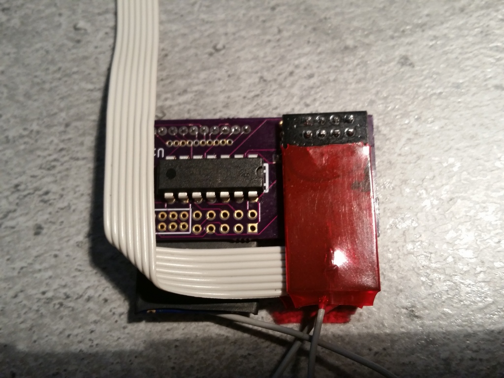

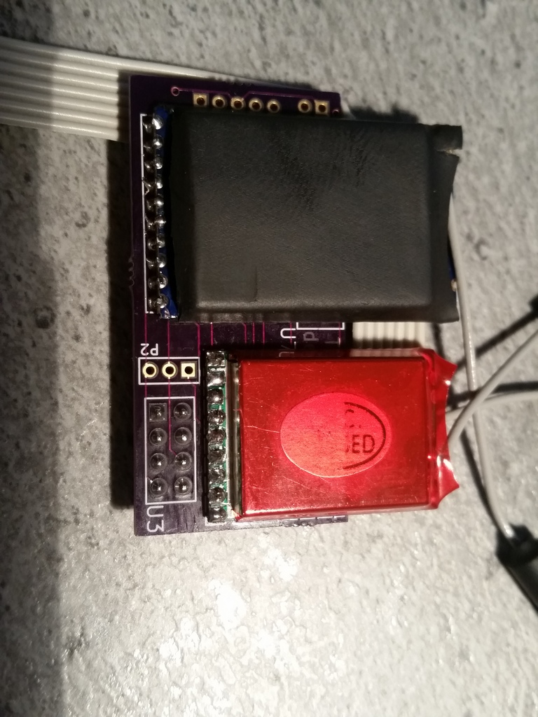

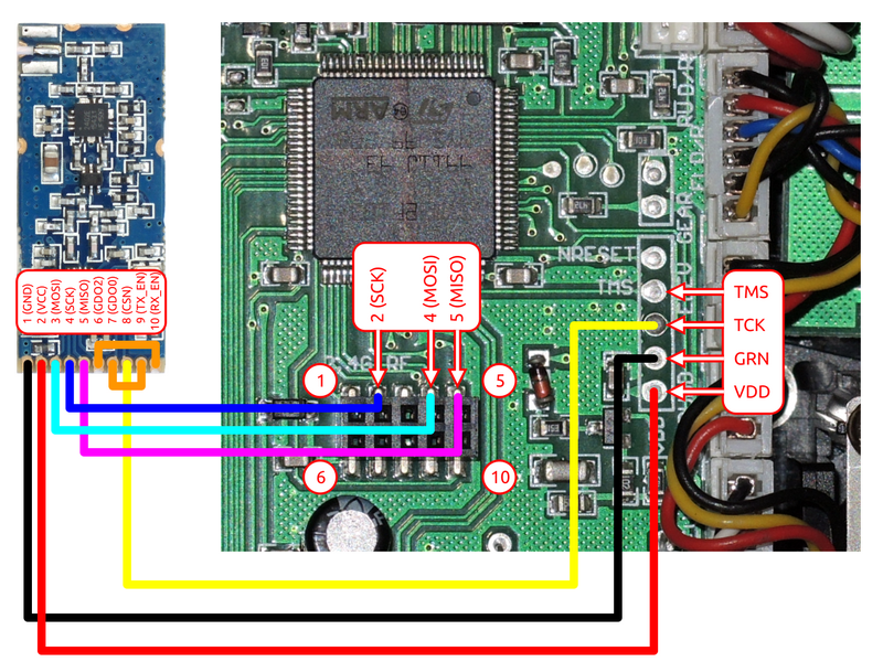

Replied by Bisky on topic [Solved] MultiModule 1.3 not detected by Devo7E
Moded like on the picture, just used Devo 7E pin-out and A15 pin. Seem to bee working, need to test it on some thing.

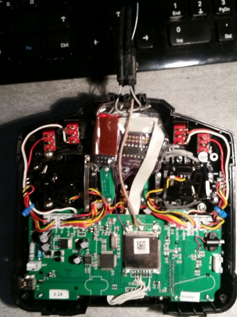

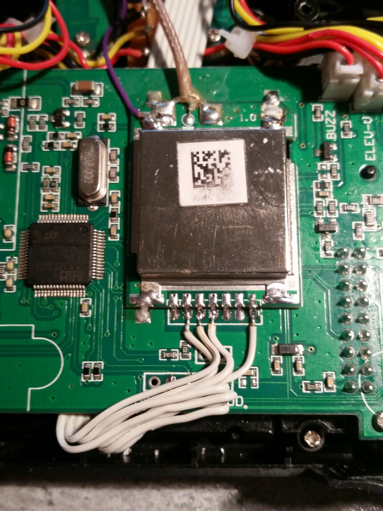

Went for the second attempt to make the MultiModule 1.3 work. I got it working, but it has a bug, the NRF24L01 doesn't always work, the A1705 is working so far, CC2500 not tested.
I'm thinking of getting a 3D printed antenna housing just slightly bigger to get all 4 3dbi antennas inside, this would be prefect...
