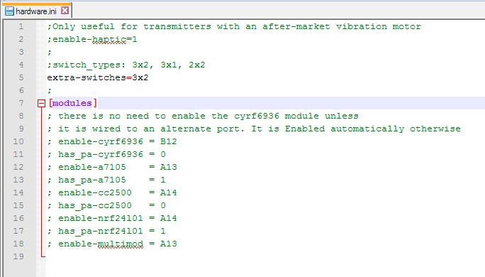

I update to the nightly....and my switch mod works ok.
But my nRF24L01 module and the A7105 NO WORKS!.... in the model setup, the protocol (Flysky, Hubsan4,etc..) appears with an *, and only Re-Init.....and I can´t bind and nothing..
With deviation 4.0.1 worked fine...
This is my hardaware.ini
Two modules are activated...
What is the problem??
Any solution?
Thanks!

- Arakon
- Posts: 305
24 May 2015 17:16 #32937
by Arakon
Replied by Arakon on topic How to update?
According to your .ini, they are NOT active. You have to remove the semicolon in front of the lines that you want to activate.
24 May 2015 18:04 #32938
Replied by PhracturedBlue on topic How to update?
remove the semicolons for lines that you want enabled. they make the code ignore the line.

Oks, noob error
Thanks Arakon and PhracturedBlue!
