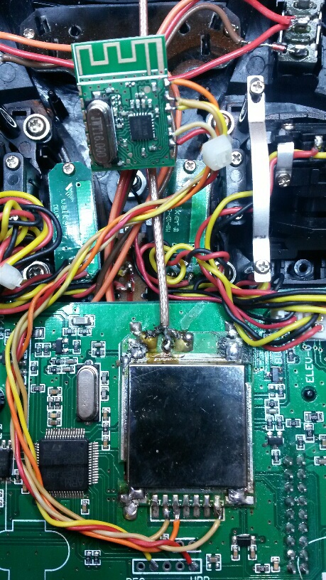

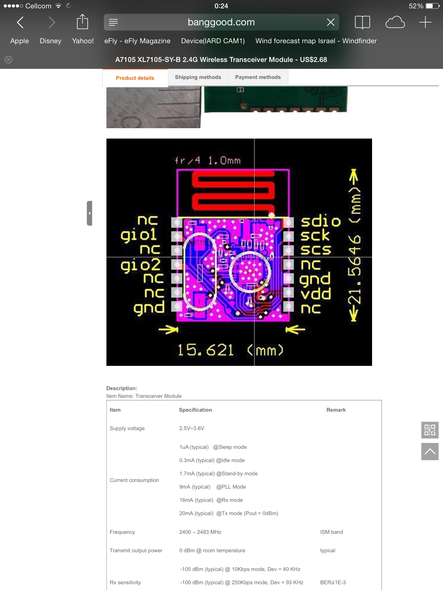

The module is XL7105-SY-B

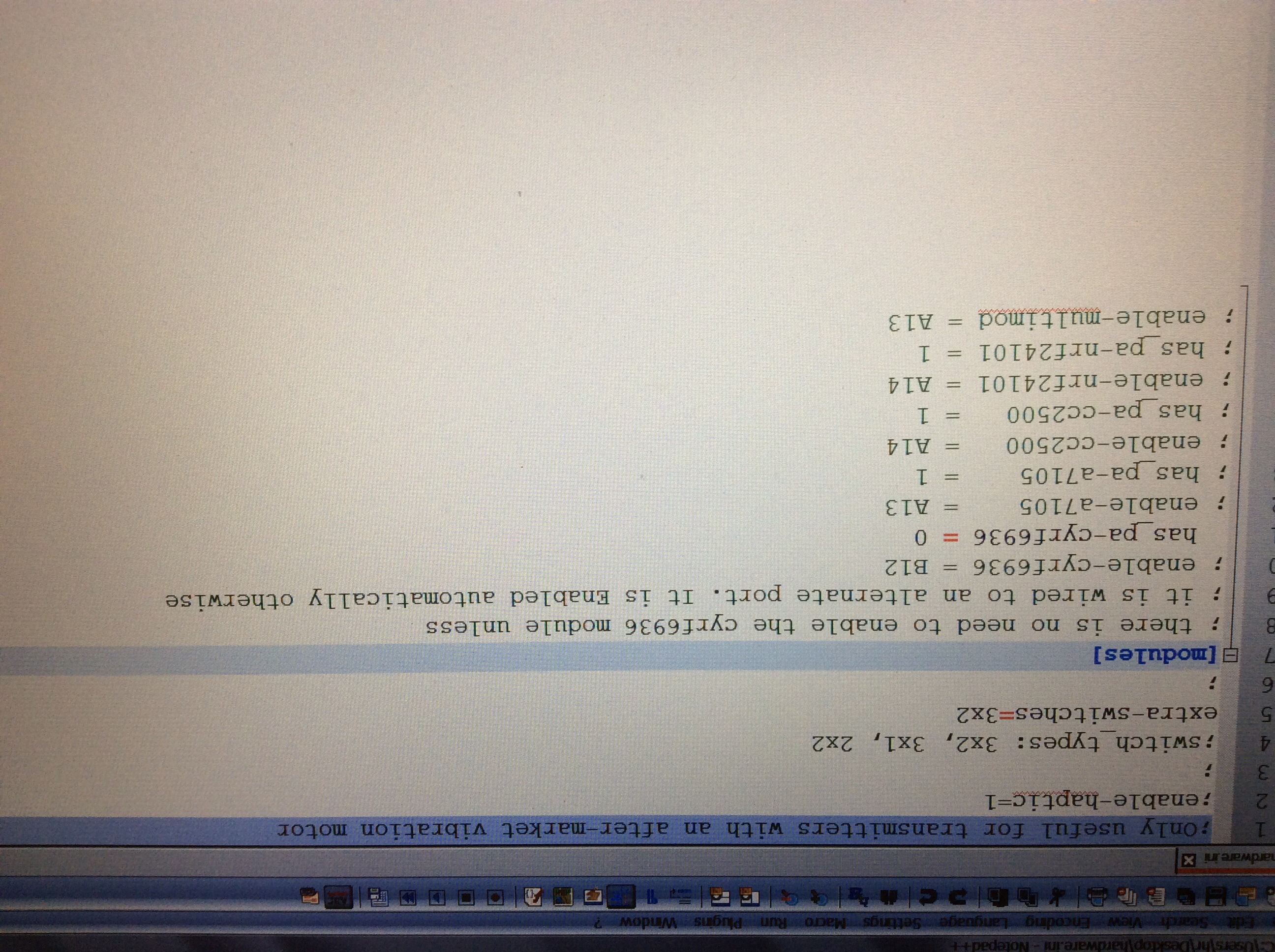

remove the ; in front of
enable-a7105=A13
enable-a7105=A13

22 May 2015 22:14 #32880
by Hr
Replied by Hr on topic A7105 doesn't bind in 7e
Hi
Now it is ok
Thank you....
Now it is ok
Thank you....
