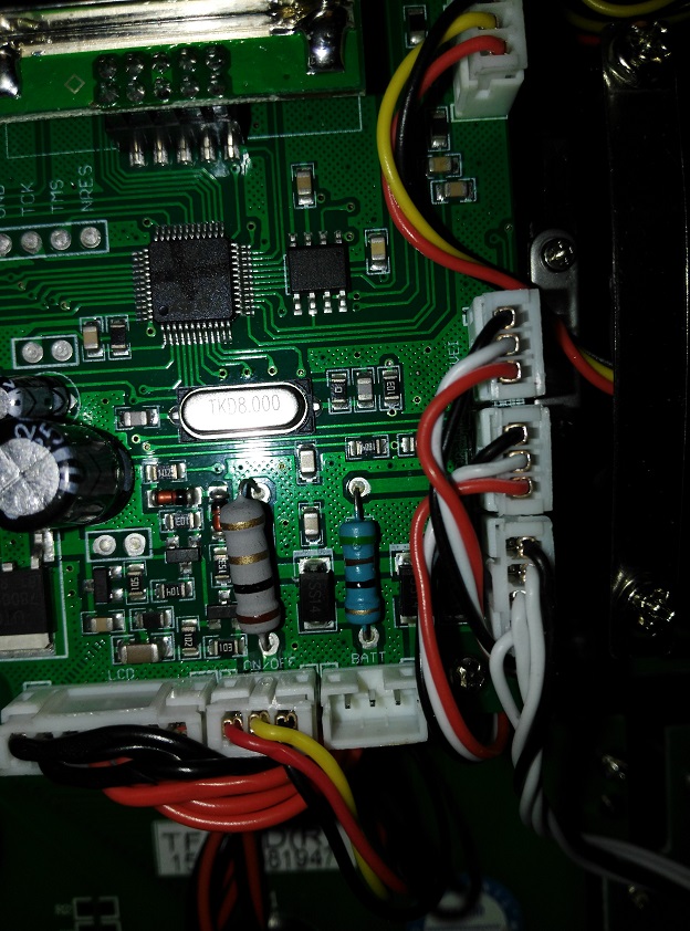

Hi, I'm new to the forum and I have a problem with my devo 7 which comprises not normally after a short circuit of the battery pack (8x 1.2 v ) , where the wires were burned. Repaired and tested battery pack , connect it to devo 7 and this does not turn . it reviewed by the interior, no impairment is displayed . In support , I connected LIPO battery 7.2 V and surprise, the devo 7 IS ON, but brand battery level 0 .
Someone knows what could have happened , if something was damaged devo 7 or a battery pack makes cut

Replied by Arakon on topic Help, short circuit of the battery pack Devo 7
Check if the diodes around that area are still okay.

Replied by inmoss on topic Help, short circuit of the battery pack Devo 7
Replace battery pack by 11.1 v lipo works well . All I had to reconfigure the radio as FMOD remained enabled by default. According manually configure MOD and now work well.
