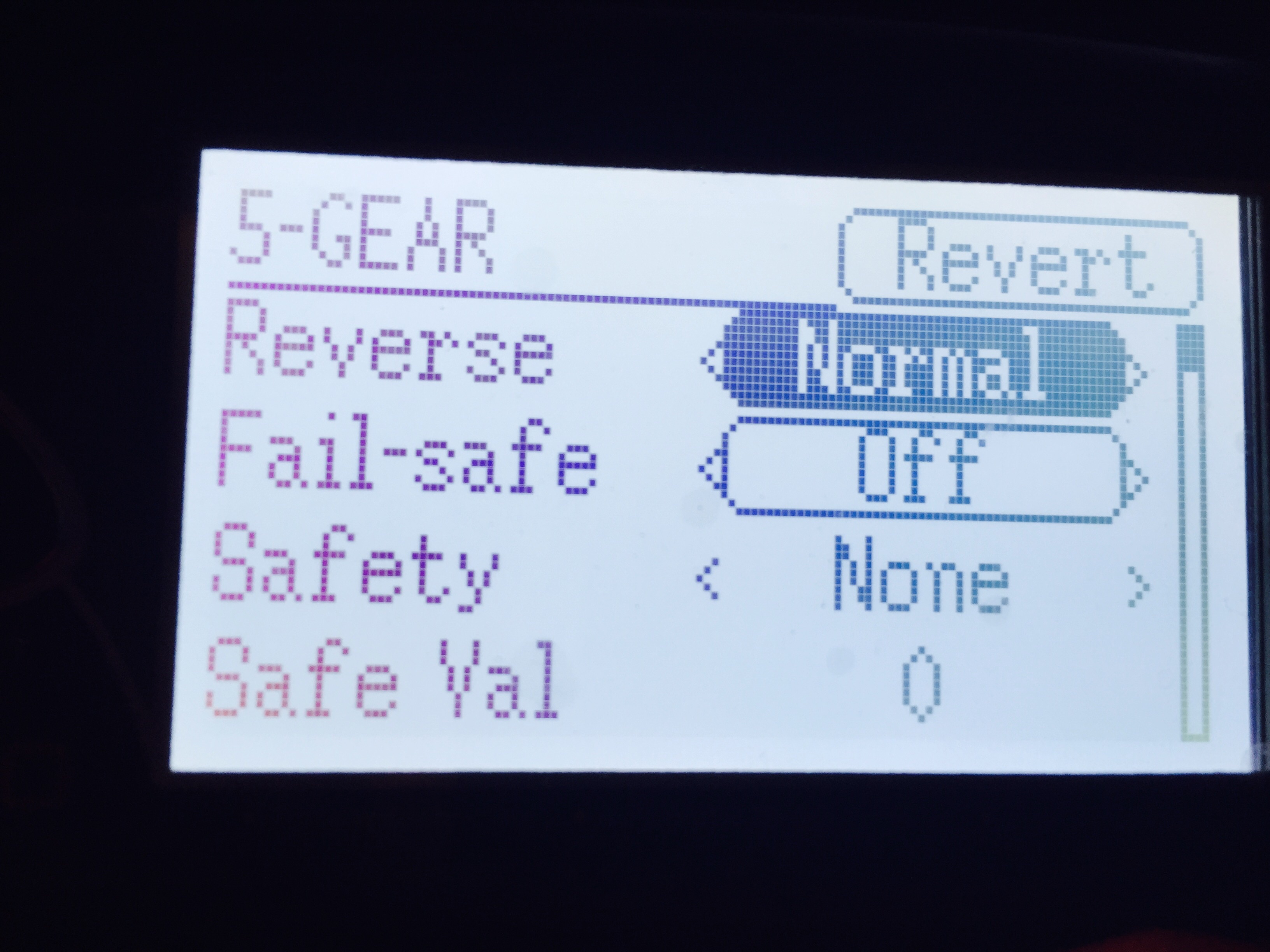

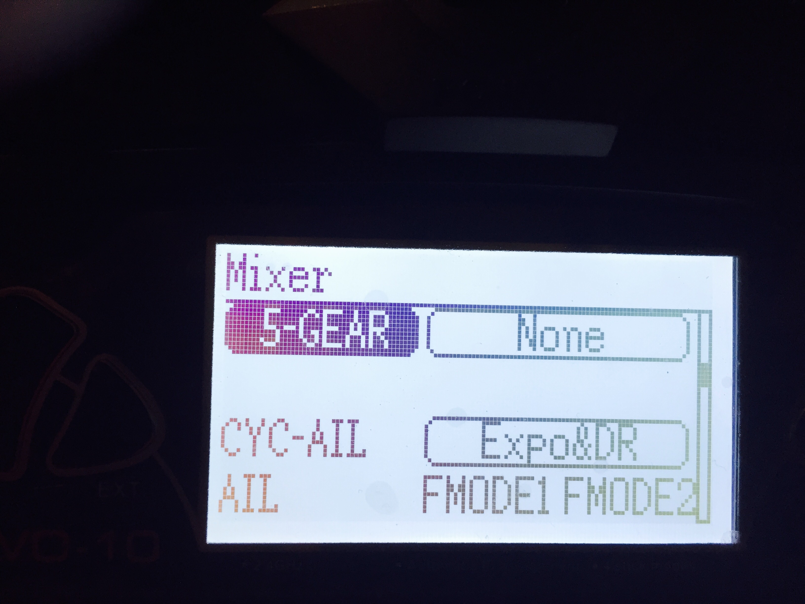

I just went and changed to advanced GUI, went back to the model menu, went to mixers and scroll down to channel 5. I wasn't given the option based on what you said....
This was my view
This was my view

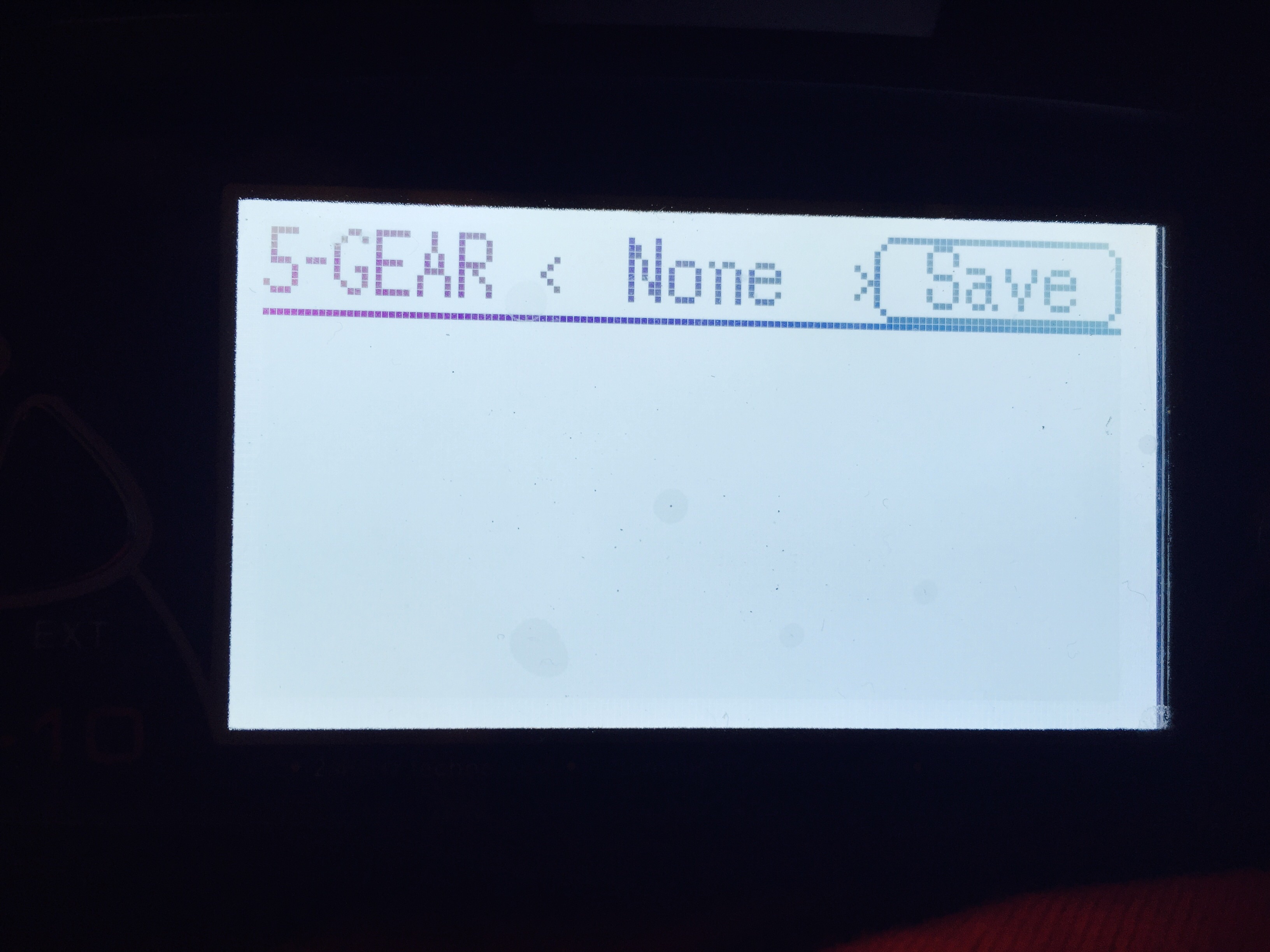

17 Jun 2015 17:01 #34228
Replied by FDR on topic How to assign channel 5 to the gear switch?
You were on the right track at your image 2.
Navigate to the <None> field, and change it to <Simple>.
Then additional filds will appear, four example the source field, which is probably named as "Src".
Change it's value to GEAR1, save it with the upper button, and you are done.
