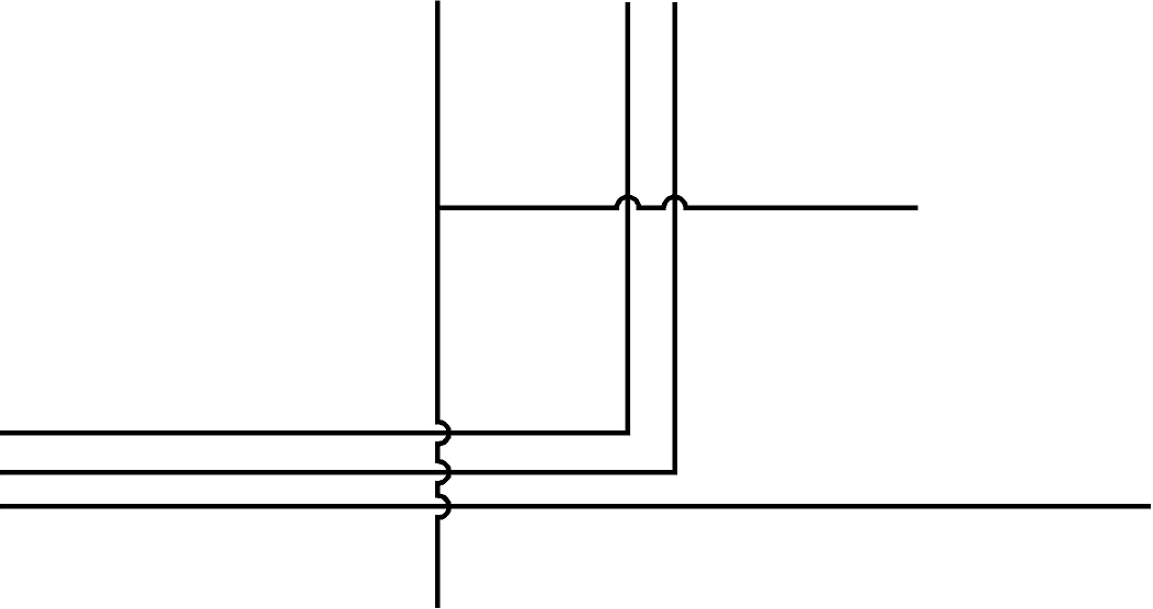

I grew up looking at wiring diagrams that looked like this:
Perhaps not proper electronics schematic standards, so as not to confuse us laymen. I never took any electronics courses in High School, ....in the span of 43-47 years ago. :P
