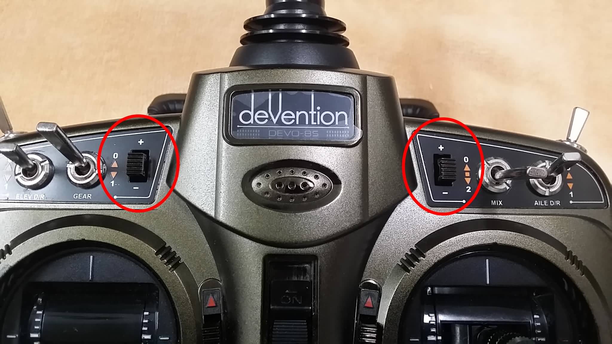

DEVO8S switch was created by dc59
Last edit: 08 Jul 2015 00:09 by dc59.
08 Jul 2015 03:44 #35241
Replied by mwm on topic DEVO8S switch
Actually, there are four buttons (up and down on both sides) there. You can configure them - and the buttons around the LCD display - as either momentary or toggle buttons, or in pairs as on/off buttons, or even as an analog value using a pair as up/down buttons.
See the manual entry on using trim's as virtual switches for the real skinny, or the last section of my tutorial on writing model config files for some examples of use.

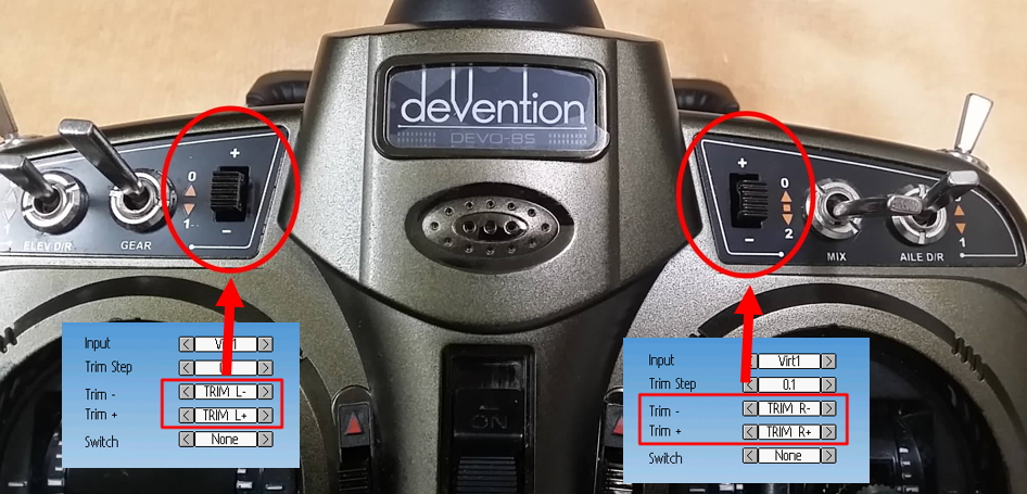

08 Jul 2015 07:43 #35244
by dc59
Is it correct ? Left trim = TRIM L- & L+ and Right trim = TRIM R- & R+
Thanks a lot.
Replied by dc59 on topic DEVO8S switch
mwm wrote: Actually, there are four buttons (up and down on both sides) there. You can configure them - and the buttons around the LCD display - as either momentary or toggle buttons, or in pairs as on/off buttons, or even as an analog value using a pair as up/down buttons.
Thanks a lot.
08 Jul 2015 21:10 #35253
Yup. The first four trim switches (eight buttons) are TRIMXDS: X is L for Left or R for Right, D is V for Vertical or H for horizontal, and S is either + or - for the up or down direction.
The last two trims (four buttons) are just TRIMDS, with the same D and S values.
