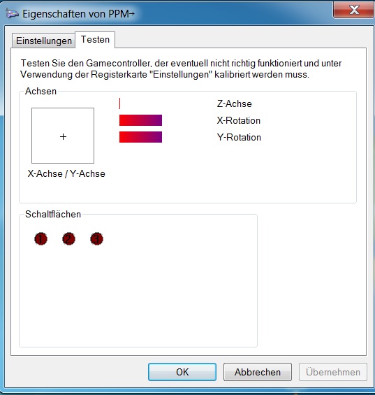

i want to use my DEVO7e as an Gamepad to use it with Heli-X. I could conect the Devo to my PC but it only reconized channel 1-4. I created an simple config with 6 Channels.
Channel 5 should be The Flymode Switch and channel 6 should be the Pitch Channel. The Channel Monitor show the right values (channel 5 off=-100 on=100) but like i said above Channel 5 and 6 willbe ignored by my pc.
Maybe somebody could help me. I try different setting without succes.
Maybe its possible to use the Hold and Fnid Switches an an simple button?! Try to use the virtual buttons but without succes

Thank you i try it but without succes. Windows is showing that the ppm connect got 3 Buttons (German: Schaltflächen) but non of them is working when i trigger any button on the Devo. The Axis are working well.
When i use the USB Cable everything is working fine but it is very unconfortable to hold the Devo.
So my suggestion is that the ppm-Usb adapter isnt working probertly
