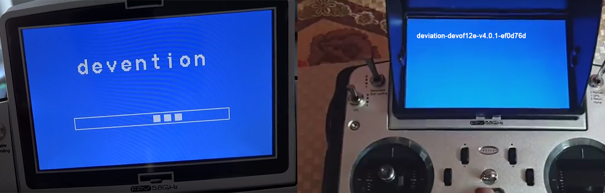

Firstly, Thanks a million bro. You saved me from big issue. I had few doubts left and I guess it will be very easy to you to clear it :) I did exactly what you said, about the STM DFU (WiUSB) tools. DFU USBDrv Installer-1.1 did not work for me but 1.0 worked. Anyways I successfully upgraded it with edited tx.ini file as per your instructions. I have made a video too and uploaded it. please watch it. I guess my battery is low, as it turned on i can see white screen fading away in few seconds so I have charged the batteries full in the night and switched on the transmitter again and i did not see that fading issue.
Now my doubt is when I purchased this product and switched on for first time i saw a screen like "devention" and loading bar. Now after upgrading i saw the folder name on screen which i upgraded. Is this ok dsplaying in that way? or may be i have to upgrade it to 1.5a or 1.6a using dfu tools 2.3.1. I just installed them in pc. Even that had detected the devo f12e now :). Anyways is that necessary for me to do or no need to do?(upgrading to 1.5a or 1.6a). If all these are not required Is there anything I have to change the settings in transmitter now as now i can see the options in monitor of transmitter. Am i good to bind with walkera drone now and fly it?
Also in the video i did not record the first screen, So i have attached the screenshot to you. See the screen attached right side and left side of image is loading bar screen(before upgrade). please suggest me if anything required. Bro once again I THANK YOU from bottom of my heart for your great help.

08 Sep 2015 07:32 - 08 Sep 2015 07:34 #37555 by dc59
Replied by dc59 on topic DEVOF12E NOT BOOTING
Hi sa,
Congratulation, you did correct procedure to install deviation FW to your F12E! :cheer:
But the bad news is that you seems got the same problem as I reported to PB last month,
File system corruption issue :
www.deviationtx.com/forum/3-feedback-que...ation-firmware#36102
I re-flashed FW again, and it's OK , I can't reproduce that and don't know what's happened! :(
Last edit: 08 Sep 2015 07:34 by dc59.
