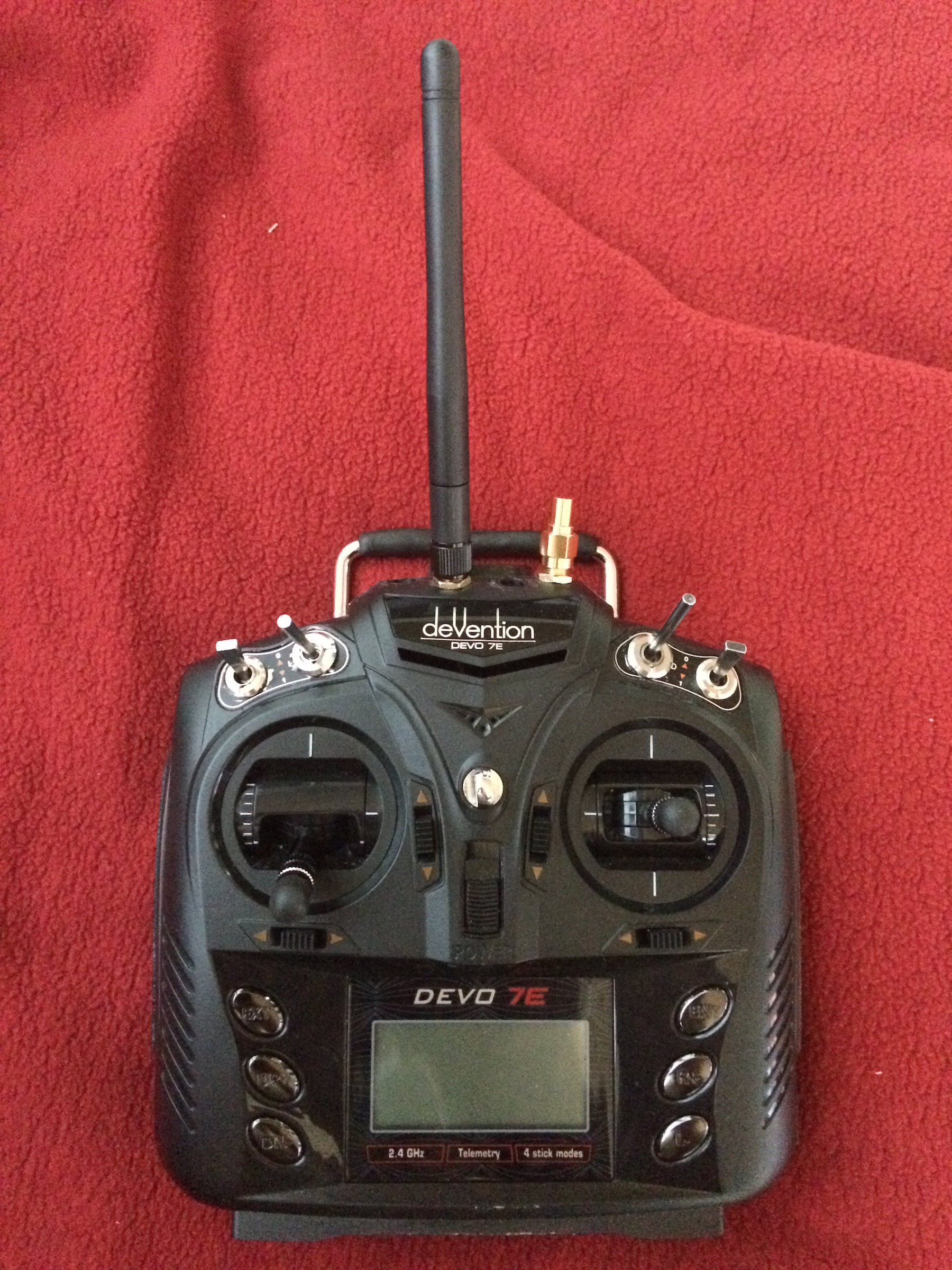

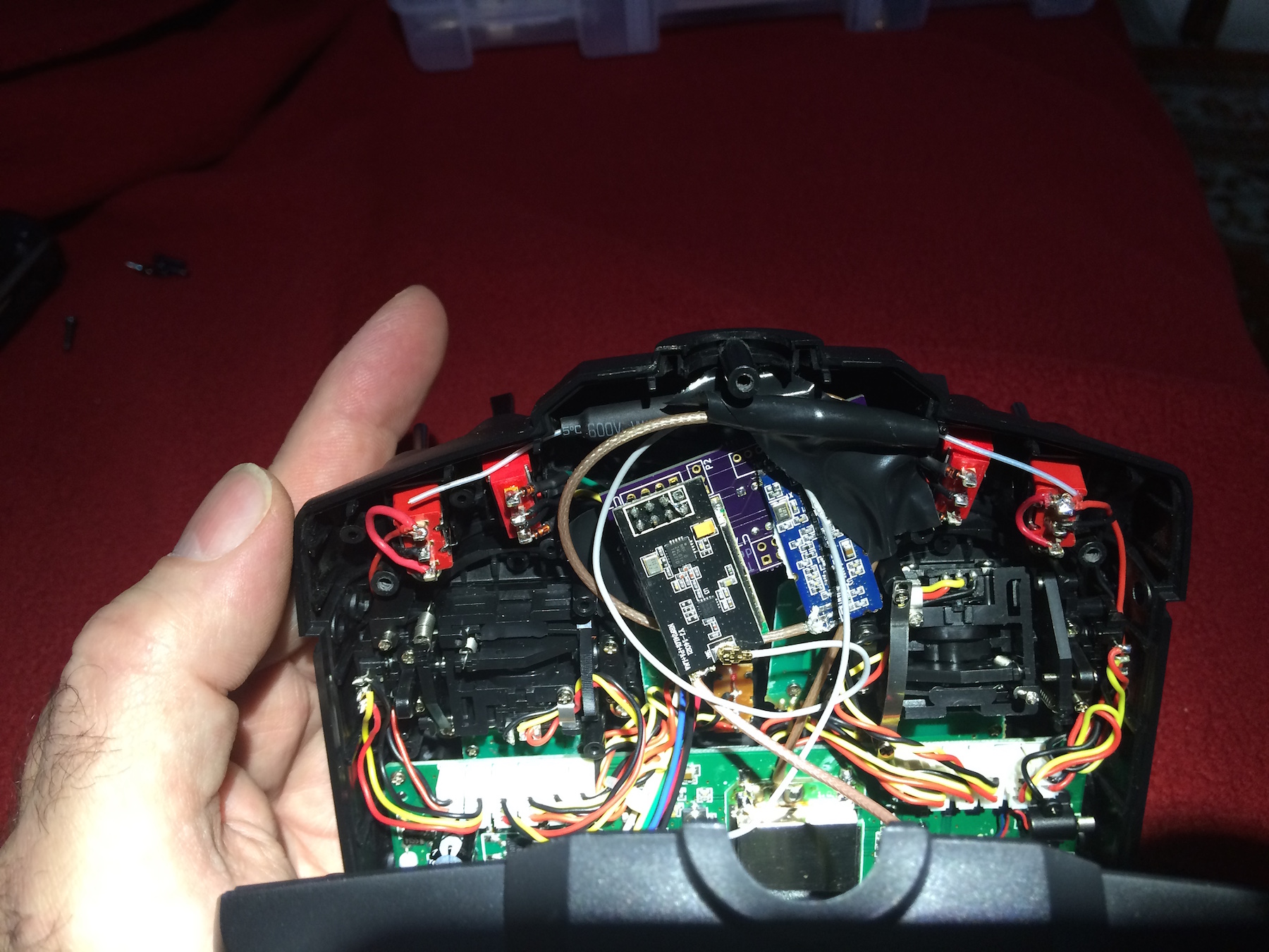

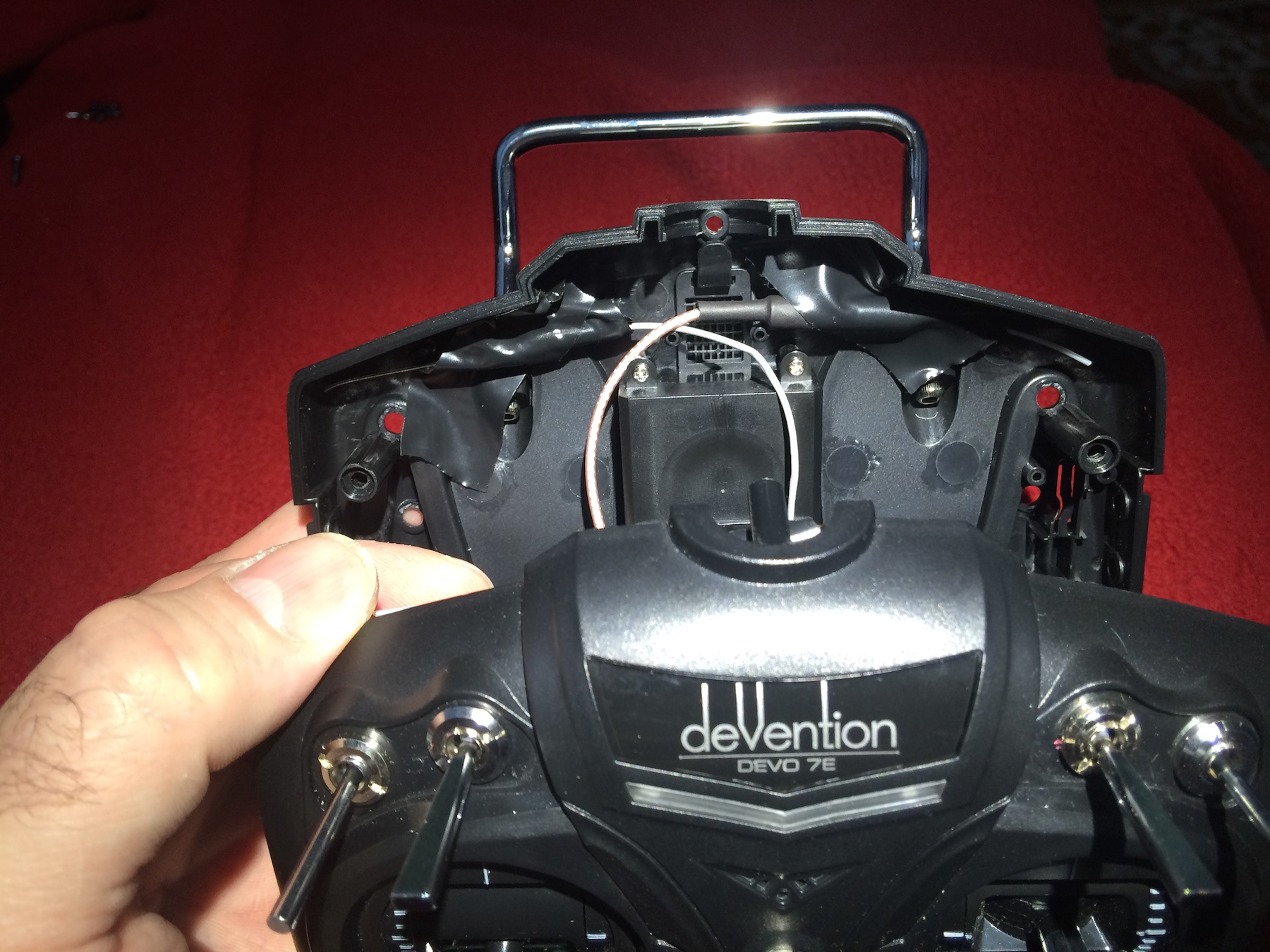

I have tried to solve this issue two different ways, and I am interested in opinions.
first is a D7e where I have an antenna mount for every module. I use a dummy load non-radiating terminator on the module antenna not being used, and move the antenna to the active module.
second is a D7e where I wanted to not have an antenna farm sticking out the top, and i have arranged the antennas cross-ways in the top of the radio , just above the switches, two in the front half, and two in the back.
I realize the first setup will get better range than the second, but so far flying off the CYRF and NRF modules I get range as far as I can see, which is all I need.
