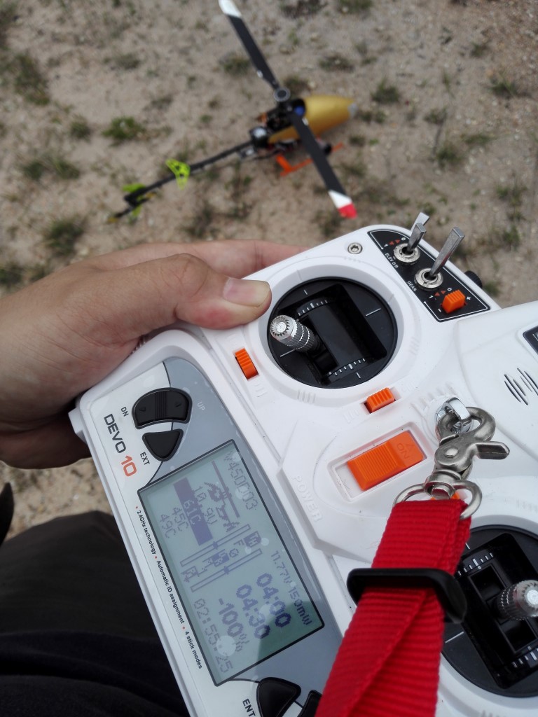

Hi guys, I just installed a WK-CTL01-D Telemetry module on my Walkera V450D03 with the stock RX2703-D RX/Gyro system and have 3 temp sensors installed and 1 volt wired to the battery connector. My problem is that the connection seems very intermittent and unstable, After taking off the telemetry boxes goes black occasionally but stays black most of the time and sometimes it would not reconnect at all. After landing the heli, even with it right in front of me, the telemetry would still be detected as offline(blacked out). After a unplugging and replugging the battery it would then connect again like normal but usually after taking off the connection would be really intermittent and sometimes while flying I have a glance down the screen, some values(let's say volt) would be blacked out while others are active.
Also, voltage reading seems to be off by around 0.2-0.4v. I do not have the fixed ID and relies on auto binding and had tried 2 antenna position, one on the frame/landing skid portion and another position on the tail boom holder, which is next to the rx antenna but also same result. Next will try placing it on the landing skid itself opposite side of the ESC but I predict the problem would remain as before this after landing with the heli right in front of me it still didn't re-establish connection. Telemetry module shows steady red.
Any suggestions guys? Really hard to find much information about this telemetry module. Thanks!

14 Sep 2015 15:25 - 14 Sep 2015 15:31 #37762
by Nightstalker1993
Replied by Nightstalker1993 on topic WK-CTL01-D Telemetry Unstable?
Quick update. After a short 1 minute 'bench' test holding the heli in my hand and spooling it up, the connection seems to be stable now. Previously the connection disconnected almost immediately after spooling up and rarely reconnects even after landing, now it does not disconnect at all but then again the heli was in my hand. Shall do a flight test tomorrow and see if the problem comes back, but so far everything seems promising. Thanks guys!
Some bonus pics on how I mounted my WK-CTL01-D though. Metallic tape on the ESC acts as a heatsink, just installed earlier, will see how effective it is tomorrow as well
