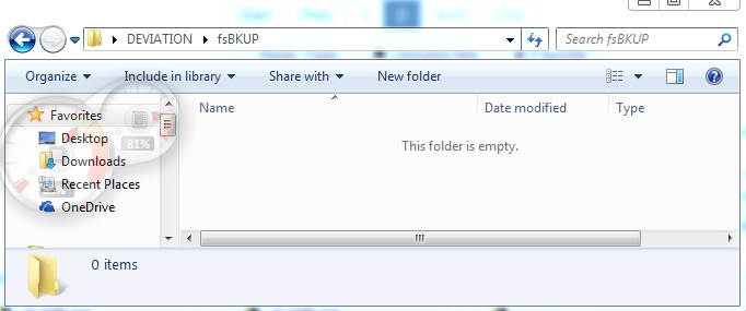

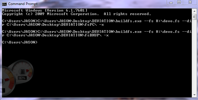

oooh good eye M8A4X...Thank You... added backslash & still nothing in folder & no error message in CMDPrompt?... Yes I have 3 folders prepared... 1 for backup, 1 for modding storage, 1 for modded ready to flash/overwrite...
C:\Users\JASON\Desktop\DEVIATION\buildfs.exe --fs H:\devo.fs --dir C:\Users\JASON\Desktop\DEVIATION\fsBKUP\ -x (Extract Tx devo.fs to Backup Folder)
C:\Users\JASON\Desktop\DEVIATION\buildfs.exe --fs H:\devo.fs --dir C:\Users\JASON\Desktop\DEVIATION\fsPC\ -x (Extract Tx devo.fs to fsPC Folder for Note++ MOD)
C:\Users\JASON\Desktop\DEVIATION\buildfs.exe --fs H:\devo.fs --dir C:\Users\JASON\Desktop\DEVIATION\fsTx\ -c (Flash/Copy/Overwrite Modded devo.fs from fsTx Folder to Tx)

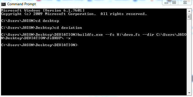

Hmm.. don't know if my DOS knowledge is that good but I think you have to change to the directory where buildfs.exe is located, try the following:
In your case if buildfs.exe is located in the "DEVIATION" folder on your desktop (and the command line starts like in your screenshot) you have to input: "cd desktop" confirmed by pressing enter, "cd deviation" confirmed by pressing enter
(in the commandline should now the following line displayed: "C:\Users\JASON\Desktop\DEVIATION\")
and finally input "buildfs.exe --fs H:\devo.fs --dir C:\Users\JASON\Desktop\DEVIATION\fsBKUP\ -x"
The same goes for the create process.

Darn...no cigar. I see your logic here, really thought it was going to work. I wonder if I should relocate buildfs.exe & destination folder(s) to simplify things?

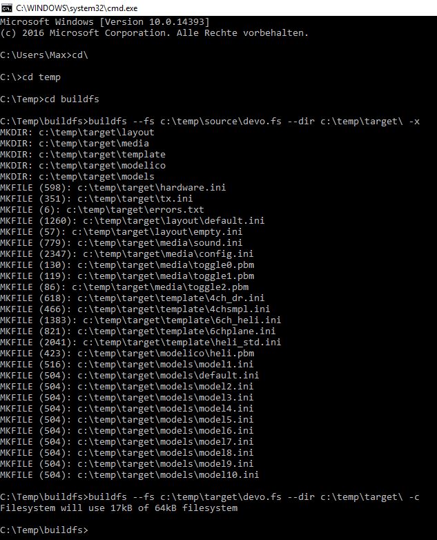

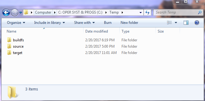

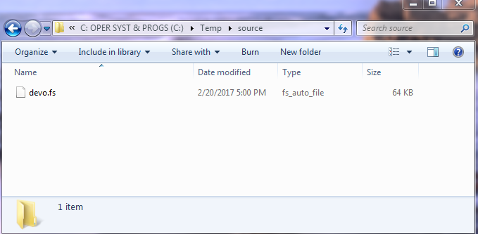

Your inputs seem ok. Not sure if the location of the devo.fs file makes a difference, at least it should not...
Just did a testrun, I placed the folders "buildfs", "soucre" and "target" into c:\temp\ and it worked well, take a look at the attached screenshot.
The "buildfs" folder only contains the buildfs.exe.
In the "soucre" folder I had copied the devo.fs file from the Transmitter.
Maybe it is better not to write directly to the TX?
The extracted files got successfully stored to the "target" folder.

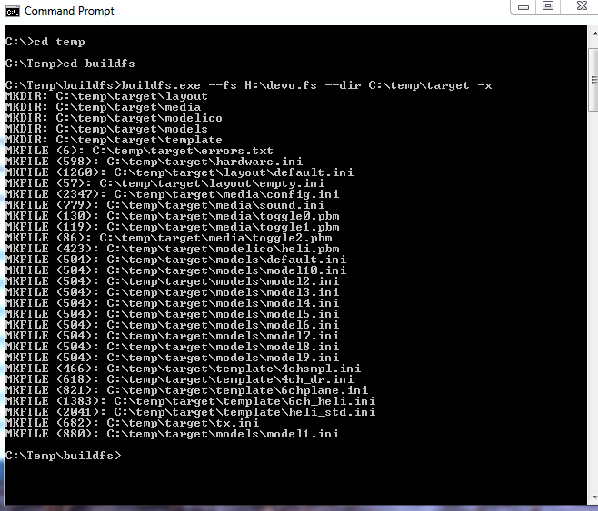

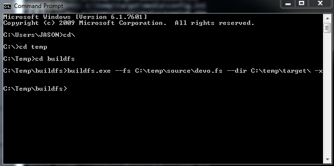

Followed your footsteps...no extraction!...something else is going on here...maybe i should delete buildfs.exe and download again & maybe delete devo.fs & reflash Tx? although Tx firmware is working

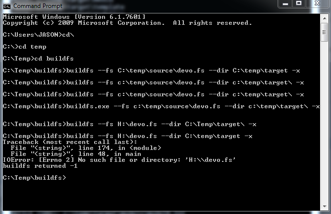

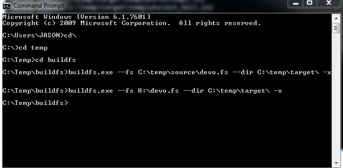

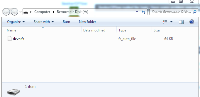

I Simplified my folder layout similar to yours for ease of command entry: I placed 3 folders "buildfs", "source" and "target" into c:\temp\ ...
-My Tx connects to PC as drive H:
-The "buildfs" folder only contains the buildfs.exe
-I copied the devo.fs file from the Tx to "source" and attempted to extract to "target" with no success, no errors popped up
-Attempted to extract H:devo.fs to "target" folder with no success, no errors popped-up BUT no extraction
I added a screenshot of my command entries...
Any insight as to what I may be doing wrong???

that should work but is your devo.fs file in your c:\temp\source directory for extraction?
DEVO F12E | Devo F7
- SeekerOfYaw
- FPV The Planet !!!
- Posts: 16
21 Feb 2017 14:34 #59408
by SeekerOfYaw
Replied by SeekerOfYaw on topic Have some problem upgrading F12E
yes, I copied & pasted it there from the Tx.

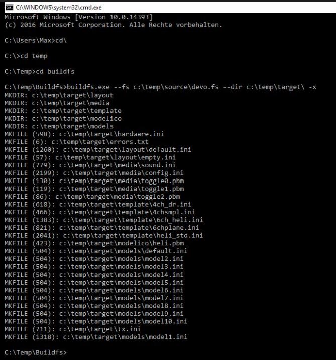

Well, I just took the devo.fs from the latest nightly build and entered the exact same commands like written before.
Attached you can find a screenshot of the commands. It worked and the extracted hardware.ini is matched to your connections of the 4in1 module.
You can find the built devo.fs attached (you need to unzip it as I can´t attach the file with *.fs extension).
Of course no models are included, but at least this should give you access to all modules.
But it is still strange that you could not build it by yourself...

22 Feb 2017 01:15 #59430
by SeekerOfYaw
YESSS! Thank You M8A4X! Feelin' the love of the Worldwide Deviation Brotherhood!... will load to Tx and let you know how it goes... the grounded NO FPV nervous twitch was going to start setting in soon lol... zip was brilliant, was wondering how you were going to attach an fs file
... unable to extract is very strange indeed, I attached some screenshots to show my commands, folder locations & devo.fs existance... Tried multiple commands with capital & lower case backslash no backslash, CMD Prompt definitely gives an error if syntax is wrong or Tx is off while extracting...Using Win 7 with multiple nicknamed drives so C: OPER SYST & PROGS should still be recognized as C: ... leaning towards an issue with buildfs.exe not actually running? I wonder if I need to update Java or something to allow the App buildfs.exe to perform it's task? I guess trying all this on another computer would be my next step...just thinking out loud... Thanks Again!!!

22 Feb 2017 01:23 #59432
by RubenRC
DEVO F12E | Devo F7
Replied by RubenRC on topic Have some problem upgrading F12E
Ah I see what your doing now. Honestly I don't think using the transmitter folder to do the extraction will work. Since there is no space there to create a temp folder while buildfs.exe opening and extracting the files before they are moved to your target directory.
I'll try that on mine. I usually just copy the devo.fs file from my TX to a local folder and manipulate the file there. I don't think java is the issue. I use windows 10 and the only reason I had to install java was for the DfuSe .

22 Feb 2017 02:09 #59437
by SeekerOfYaw
@M8A4X
Copied your devo.fs file to Tx...Began set-up on 2 of my custom racers and rebooted... all settings saved properly!... vid signal is good!...have not tried to bind yet but No Fear!...You my friend are a CHAMPION! check this attachment out, worked first try!!! not sure what was corrupt in original devo.fs file BUT ALL GOOD NOW!!!
now to set-up my 4 customs & learn how to BUILD/MOD w/ Notepad++ for my BNF micros
...1 Tx TO RULE THEM ALL!!!...hope sometime soon I will be able to help other noobs as you have helped me... thanks again for ALL your time & effort

22 Feb 2017 03:21 #59439
by M8A4X
Replied by M8A4X on topic Have some problem upgrading F12E
Glad it worked now on your PC!!!
So the only change was that you used as source the devo.fs file I previously attached to my post here? I tried both ways, copied the devo.fs from a freshly formatted and installed nightlybuild from my F12E (copied it to my PC, I did not let buildfs.exe read it straight from the TX) and also took the devo.fs straight out of the downloaded nightlybuild.zip file. Both worked.
By the way, the command promt does not care about drivenames given in windows (in your case OPER SYST & PROGS), it only cares about drive letters. Also capital letters do not matter (at least in DOS, e.g. linux is another story...).
Either way im glad it worked finally!
