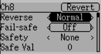

Failsafe is an Rx feature, not a Tx feature. It has to be - if the Tx has lost communication with the Rx, then it can't tell the Rx what to do! Some protocols have facilities to let the Tx send failsafe values to the Rx; others don't. Instead you do something on the Rx to use the current values from the Tx as the failsafe value (i.e. - a button on the Rx, set at bind time, etc). Those obviously don't care whether the Tx is in heli mode or not.
The Walkera protocols are the only ones that have Tx-sent failsafe values in Deviation. To set them, you have to use the Advanced GUI. Go into the mixer. select the channel name for an output channel, and the second setting controls the failsafe value for that channel. Hit Ent to toggle it between On and Off, and use the Left/Right keys to change the value when it's On.

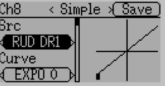

2. I need to set Chanel 8 in Fail Safe into high value (turn on beacon, for example)
Can you show what second setting you mentioned ?

- RoGuE_StreaK
- Posts: 486
06 Jan 2016 20:11 - 06 Jan 2016 20:12 #41446
by RoGuE_StreaK
On the screen before that one, where you have "ch8" and "simple", instead of Entering through to "simple" go throught to "ch8" instead; it's also a button
Replied by RoGuE_StreaK on topic Fail Safe in Plane Mode
I knew I shouldn't have clicked the spoiler!dr.wagen wrote: Can you show what second setting you mentioned ?

- dr.wagen
- Posts: 10
06 Jan 2016 20:21 - 06 Jan 2016 20:28 #41447
by dr.wagen
Replied by dr.wagen on topic Fail Safe in Plane Mode
Catch up! This is super. And I'm really blind.
Thanks a lot!
