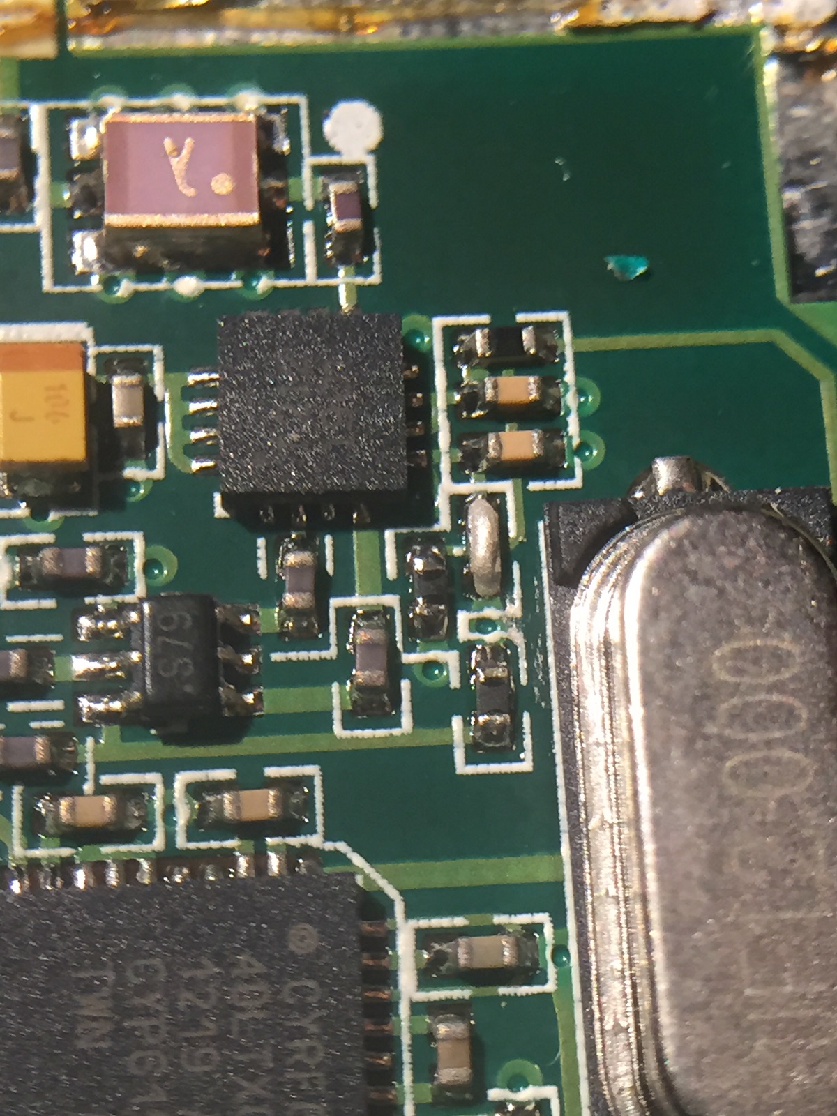

I'm having a big problem with the range of my Devo 7e when using it with DSMX/DSM2 protocol.
I did my range mod using this conductive paste that I bought from Banggood. See photo of my finished range mod attached.
After that I added the A107 and nrf24l01 modules. Both of these modules work correctly and I can fly Hubsan, Nihui, MJX, Syma and Eachine toy quads.
But when I try to fly my Blade Nano QX which uses DSMX, once the quad gets beyond 5 meters I lose control of it. I already have the transmit power set to the maximum of 150mw.
I did not do any soldering underneath the RF shield so there was no chance I damaged anything in there. I don't understand why the range is so poor.
I'm using this test build (deviation-devo7e-v4.0.1-e9e4b2c) of DeviationTx that has the MJX protocols.
I've also attached my hardware.ini and tx.ini files.
Any advice on what might be causing the problem?

Replied by aMax on topic Getting only 5 meters range using DSMX on Devo 7e!
Did you read all product reviews..? Some report it isn't conductive at all.
Have you check your work with a multimeter? In the end your devo should work at least as before.
If not, something different must have happened.
How did you remove the RF shield? Inspect the antenna wire soldering point....

Ok, I tested my tube of conductive paste by spreading a good amount out on some cardboard, letting it dry and then using my multi-meter to test conductivity.
It has zero conductivity! So it was a big mistake for not testing it out before using it to do my range mod.
I've also updated the firmware to the hexfet test-build protocol combo.
And commented out the has_pa-cyrf6936 line.
The range problem still exists.
So my question is: Since I've already soldered on my A107 and nrf24l01 modules, is it still possible for me to remove the RF shield again to try this mod with some good quality conductive paste?
Thanks!
