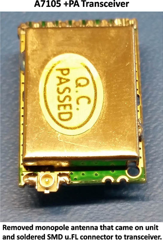

Hmm. Can't help with the SMA A7105. Did the other options tested include a u.FL connector? The standard A7105-500 recommended for deviation has a pads for an SDM u.FL connector with a short dipole antenna soldered to it for some reason. Removing that dipole is the first step in getting extra range out of it, and soldering a u.FL connector to it isn't a lot harder than hacking up an SMA cable to solder to it as is often suggested.

All I did was cut off the female end of an sma cable and split the shielding on the pads to the right and left of the antenna pad, than soldered the antenna wire to the antenna pad.Just make sure there is no touching or solder drips between the 2.Take a magnifying glass to analyze it closely I then got some liquid tape and brushed it over the soldering,then I got a piece of shrink wrap and secured the module.My u807 has great range.Hope this helps.Whoever put that u.l connector on that module did an awesome job,that's beyond my skills,lol.

While mine isn't as neat as RedSleds - it was the first time I'd done SMD soldering - it was easier than doing the cable hack and soldering that on.

24 Feb 2016 05:39 #43544
by RedSleds
Flux pen made it easy, solder flowed good with a quick touch of the iron, and sucked in right where it was supposed to go. The hardest part was keeping that tiny thing aligned properly until the first pad was soldered, ....man that thing is small !!!
Replied by RedSleds on topic A7105 with SMA connector?
That was my first time soldering anything SMD.mwm wrote: While mine isn't as neat as RedSleds - it was the first time I'd done SMD soldering - it was easier than doing the cable hack and soldering that on.
