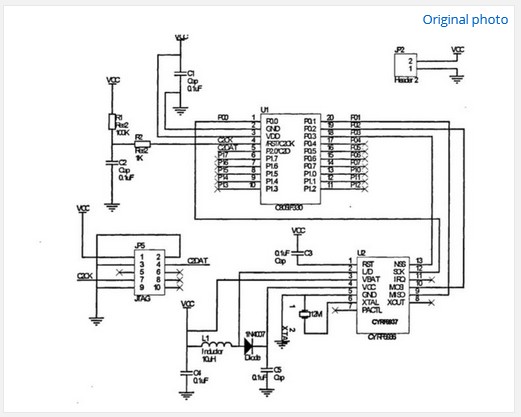

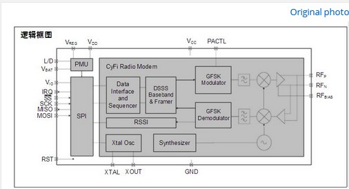

Do you think that this module has the same functions as the original?
Strange, he has no shield to.
Thanks for your help.
www.aliexpress.com/item/2-4-G-module-CYR...ule/32613374852.html
Last edit: 25 Mar 2016 16:37 by saidem.

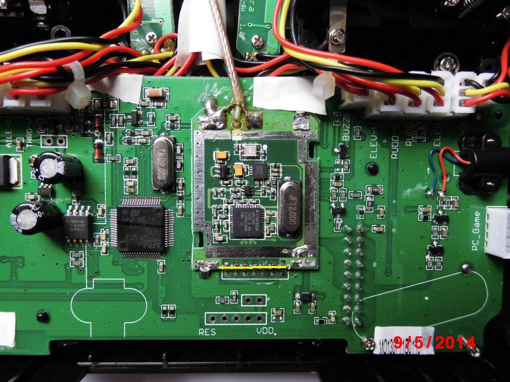

I wanted to remove the Devo 7E module to replace the antenna and put it outside. But unfortunately I strongly pulled the module and I ripped connections from printed circuit. Could you tell me how to do for desoldering the module because you have to desoldering 7 connections simultaneously? That's the next time I take myself a little better !!!
Thanks a lot.
Thanks a lot.
- aMax
- Posts: 776
07 Apr 2016 19:04 - 07 Apr 2016 23:49 #46055
by aMax
Replied by aMax on topic Stock CYRF6936 power at 150mW in Devo 7E?
One save way is cutting each connection at the RF module just at the edge.
Clean the solder points on the module and cut the connection one by one (dremel or scalpel).
Secure this area with tape if using a dremel......
After lifting the module you can remove therest remaining parts from the main board, .....one by one, with ease.
Last edit: 07 Apr 2016 23:49 by aMax.

Thank you very much for your answer and photo, I would not dare cut the module with the dremel, but I think this is the right solution. Otherwise you would have a picture with the Devo 7E Module removed and replaced with the Devo8 Module / 12. Because I want to see the detail of welds and connections.
A big thank you again for your response.

See the connections here!!
www.hacksmods.com/2014/10/wk-devo-s-mod-module-for-devo7e/
- saidem
- Posts: 216
08 Apr 2016 14:21 #46113
by saidem
Replied by saidem on topic Stock CYRF6936 power at 150mW in Devo 7E?
In the photo I can not see well, but I think all the old circuit is removed even at the connections of the original one, is that it? Because at this place it's pretty difficult to do!
- ursus69
- Posts: 143
08 Apr 2016 15:10 #46115
by ursus69
Replied by ursus69 on topic Stock CYRF6936 power at 150mW in Devo 7E?
- saidem
- Posts: 216
08 Apr 2016 15:40 #46116
by saidem
Then it's very clear. I had not seen it. Thank you and have a good weekend. Now I put myself in solders.

@saidem I use couple of tricks to desolder such things - solder wick or desoldering bride - it's a copper wick which dries out the solder - after this you'll find out that the module is not that strongly connected. For some especially stubborn places I use Chip Quik - it's a low temp solder which when mixed with blobs of solder your try to melt lowers their melting point significantly and it becomes possible to keep molten many pins at a time. You need to be careful with it - if it goes to unwanted place it will make it melt also. And you need to clean after it with mentioned wick very thoroughly.
- saidem
- Posts: 216
09 Apr 2016 08:44 - 09 Apr 2016 08:54 #46160
by saidem
I use the pump and desoldering wick, but it is still hard! The problem was with the 7 module connections through the printed circuit and their feed is on the other side. On this side there is the display and you can not drop it because it is welded on two sides and has 18 connections. We must be sure that the connections through the circuit well. But with all your advice it should go now.
