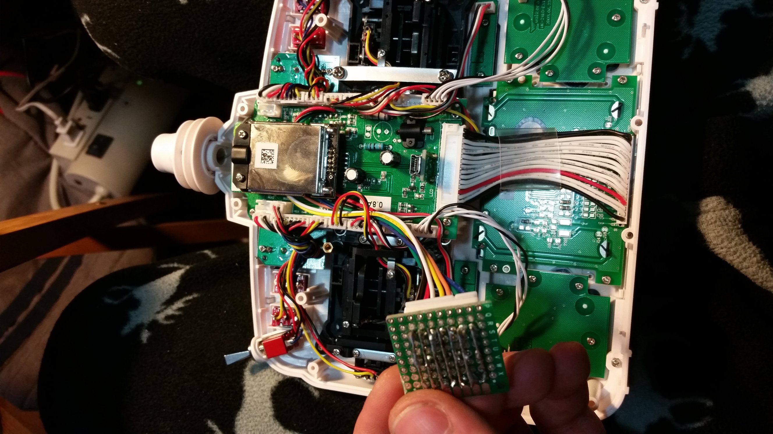

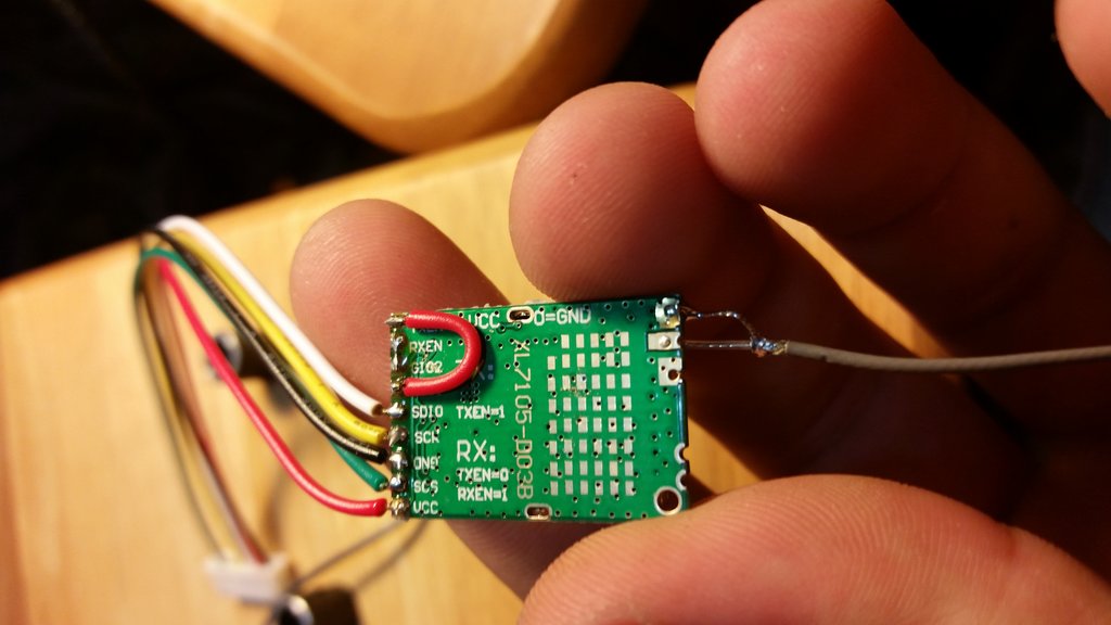

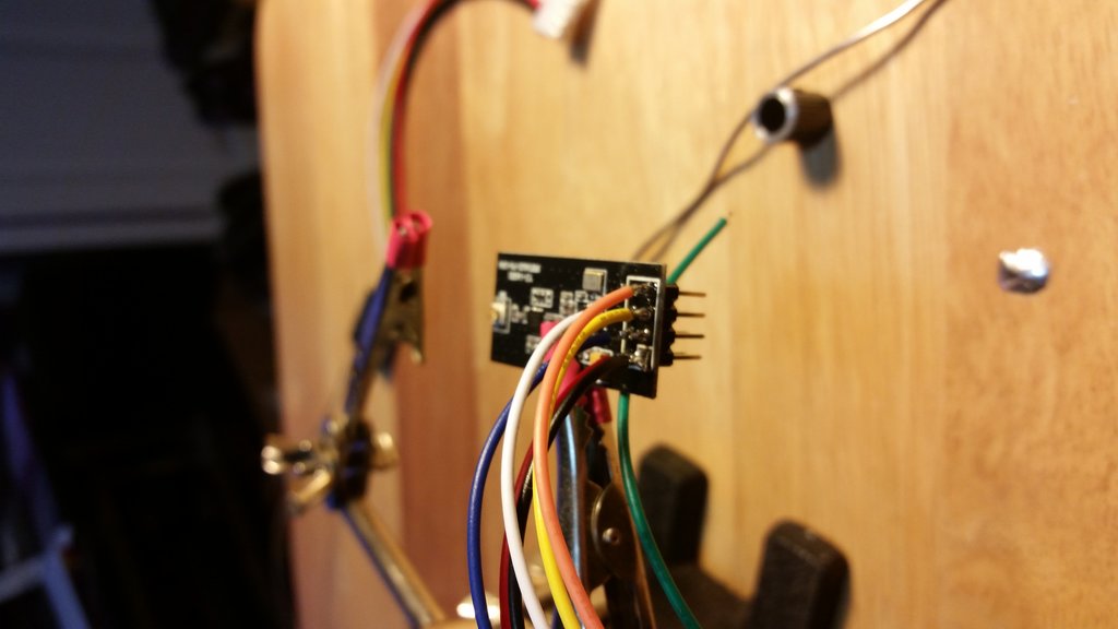

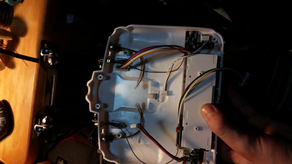

If there are warnings of missing modules, it seems the custom here is to publish the hardware.ini file and post picturesof the modules installation/soldering so people can help you check where the fault might be.

As for the pictures, I've no good knowledge of transmitters other than the 7e, so will leave knowledgeable people ones give answer that part. (But liiks like we miss details on the color code you use, the "distribution board" you've made (that square thingie), the pins it's connected to on the tx's board.
Still, if only the 7105 module is found out as missing, you should be able to use your model (which uses the NRF module), I'd check that first.
(Make sure the modules have antenna on any time they are powered!)
