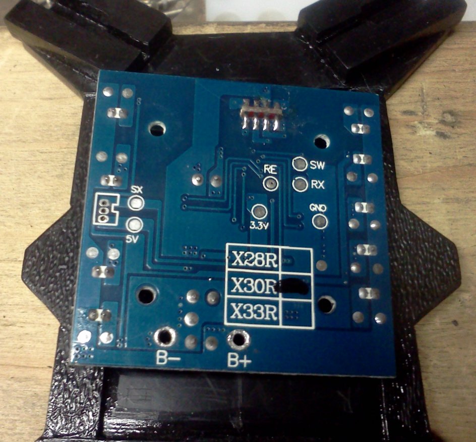

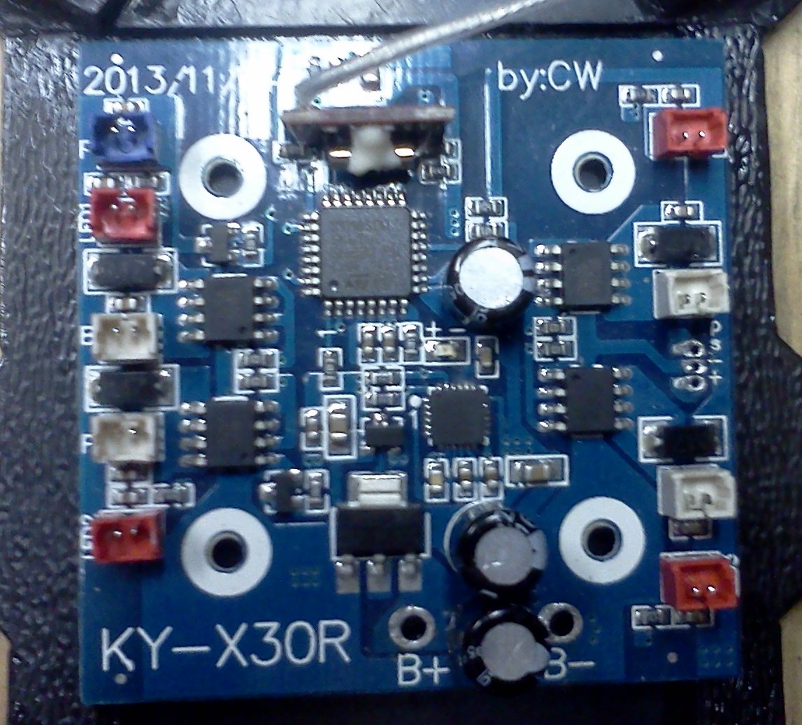

I am hoping someone here can tell me what/which Receiver IC/Protocol this Rx/FC PCB uses?
It is from a "Drone" called "Intruder UFO" by "XinXun".
Front:
Back:

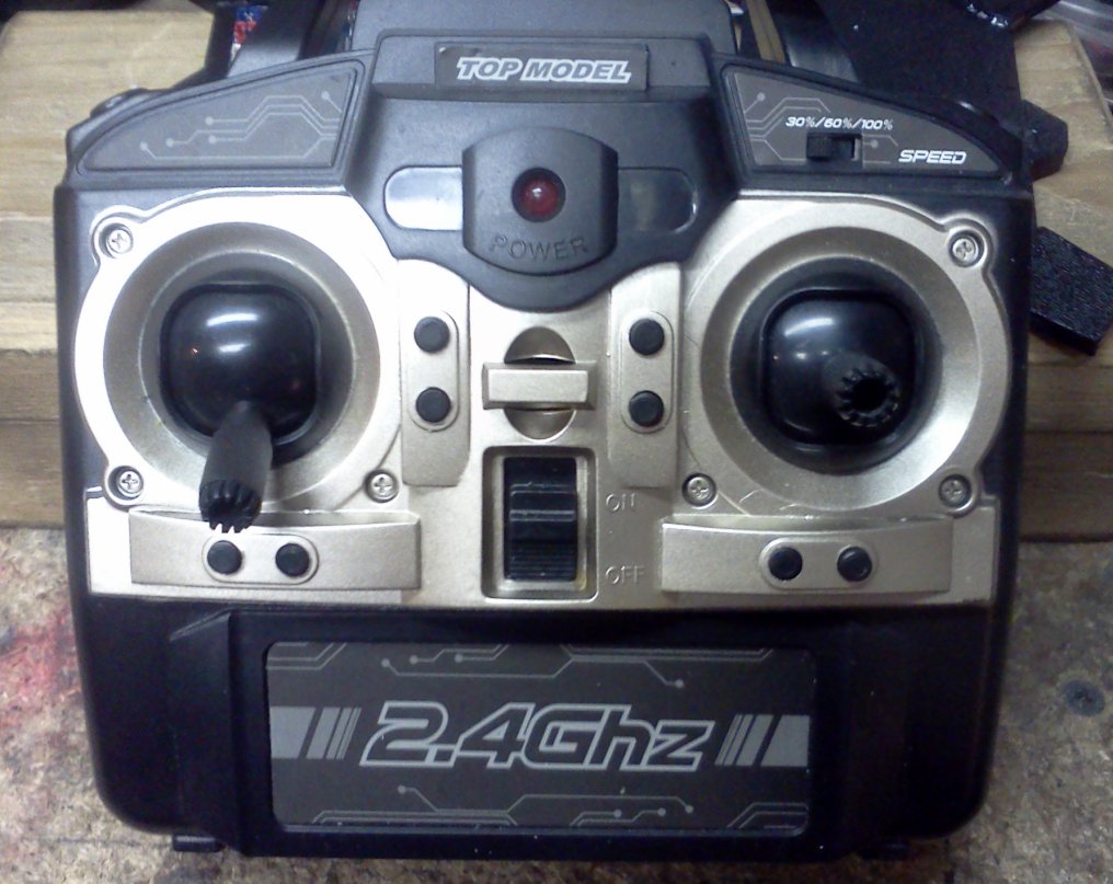

Its Transmitter:
I have not been able to find any data about this product (that I could read anyway).
It is a friend of mine's and he crashed it hard enough that the tiny little frame that holds the Rx/FC PCB & Battery is fubar because it lost signal suddenly while close but high up (and never regained signal even though the decent brought it closer).
I'm (we are) hoping the Rx IC is one that can bind with a Devo7e and Deviation FW, without requiring an additional Tx Module - if possible.
I've looked inside the transmitter that it came with and concluded it is marginally better than my Syma X5c-1 transmitter (when it was stock),

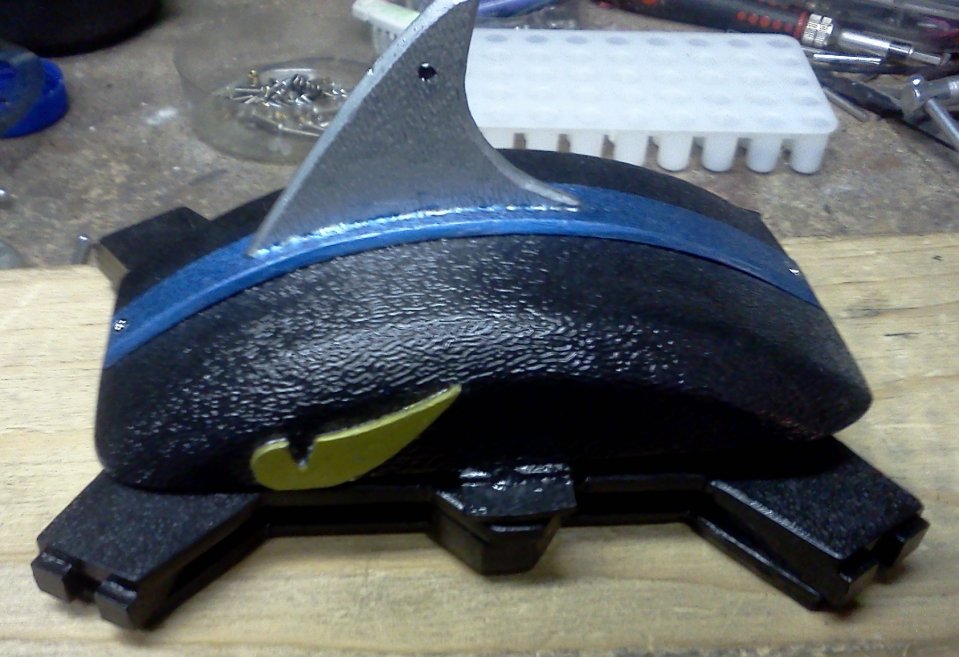

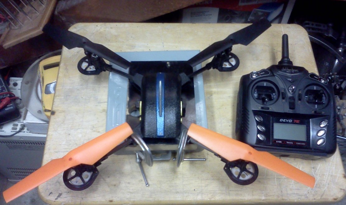

Since I'm putting the Rx/FC PCB and motors on a custom frame I made (see next picture) and have shortened the carbon fiber booms for the motor pods by half, (so it will be
lighter, more rigid and have shorter moment movements and smaller visual aspect), using a full range Tx with computer mixing and such might be needed
to keep it under control better. (at least enough so my friend can have more than the 3 practice flights it gave him before the high dive on its last flight.
(Its new size is 295mm on cross-diagonal prop centers and yes, I had to cut about 1" off the props for clearance.)
New Body:
Mock-up:
Btw, I'm calling the New body design a "NightShark". It is also getting a lighting (LEDs) upgrade also so we can do some late evening / night flying when finished. (this weekend we hope)

I think that's a v2x2 board, the rf chip is actually on the vertical board with the antenna, we'll need a pic of that to be sure, try and angle the light so we can see the printed text on it
07 May 2016 00:59 - 07 May 2016 01:00 #47935
Replied by hexfet on topic Help identify Quad Rx/FC PCB please.
There's a XinXun protocol option in yd717, which requires an nRF24L01+ compatible module installed. The name is no guarantee it's the same protocol, but it could be.
The vertical board looks the same as the modules in the yd717 transmitters.

@HappyHarry - I'd have to scrape the adhesive off holding the crystal in place on top of the COB (Chip On Board), to see if they even silk screened a part Id # on it.
Most of the COB surface is visible and devoid of any markings, so I'd rather not risk doing damage to unit. I'm getting paid to fix it, not break it while not being flown.
These proprietary products usually do not mark any custom COBs to prevent someone copying design or reveal they copied someone else or are producing them as cheap as possible, so don't bother to mark every component.
This one only has a PCB # and version # printed on it (the vertical RF daughter board)., and reason I asked here hoping someone recognized it or has/had a better name brand version which disclosed what HW is in use. No search of anything printed on receiver I did gave results remotely related to this thing.
I really miss the ol' days when "English Manual included" meant you get a concise technical manual Written In English, not as what you get now..- a Pamphlet Written With English Words.(and that have nothing to do with the products specs or functionality it seems).
This is one of those products and glad my friend didn't spend too much on it (won it at a fair/carnival skill game he claims).
At least I can now stop trying to get it to bind with my Devo and finish the build. Repair work done and electronics tested good (with its Tx).
The Rx antenna was originally soldered to the other side of the PCB so it was positioned right above the FC parts MCU and (brushed) motor drivers
and Imho, the cause of the drop out(s) he was getting.
