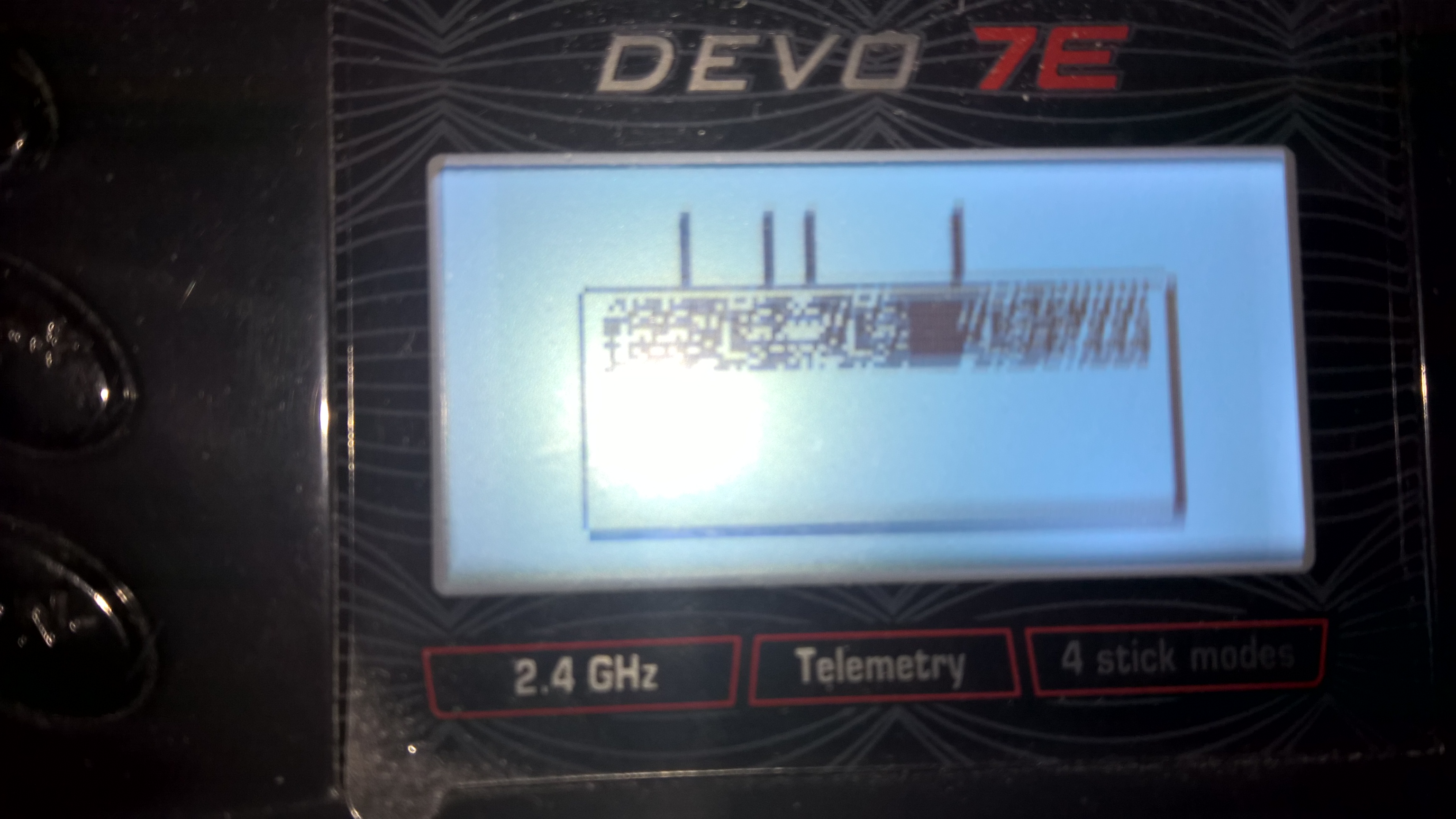

Devo 7e won't go into USB mode, it bleeps and displays the folowing-
How do I get it to work now??
Last edit: 25 May 2016 17:40 by norris.

what happened prior to this? did it ever work? what version of deviation have you installed etc etc etc
in other words we need more information

Make sure you flashed with the devo7e version, not the one with -emu in it. And you need to reflash. Hold down the EXT button while powering up, and tell us what you see.

Switching on I get "bad missing /Devo protocol" or words to that effect message no helicopter icon.

are you remembering to copy across the filesystem including the protocols folder from the zip file you downloaded?
