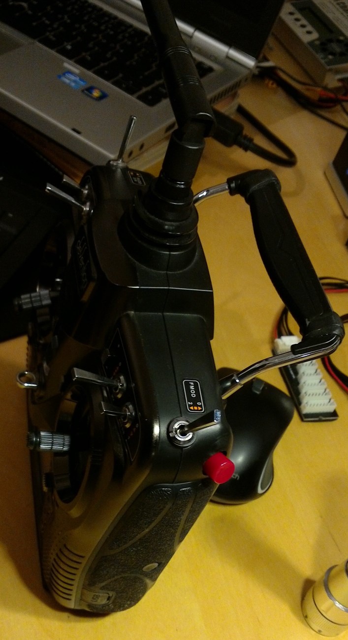

btw that is my panik button, very easy to reach during the flight.
