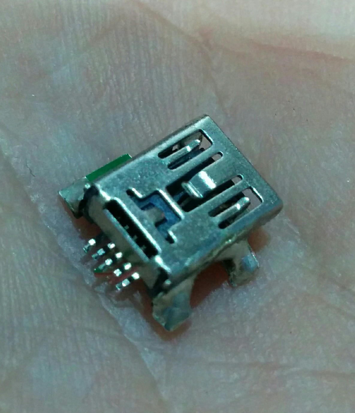

Devo10 USB port came off.
04 Sep 2016 14:36 #53470
Devo10 USB port came off. was created by mwm

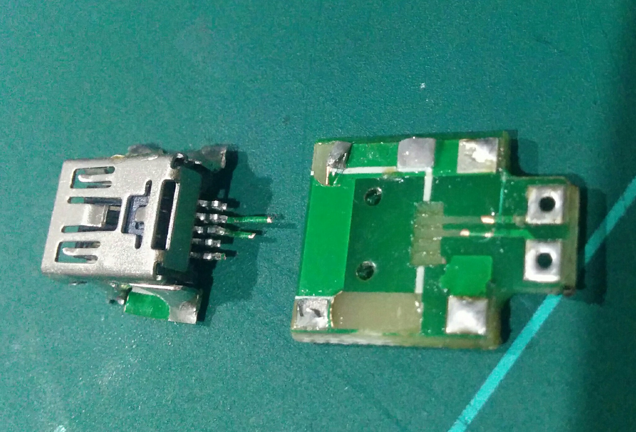

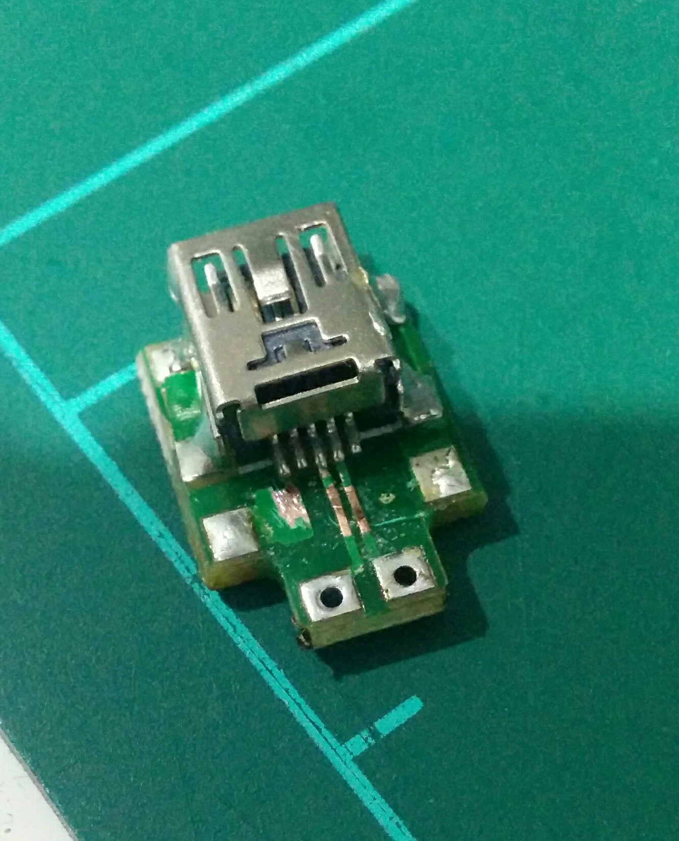

It's clearly a SMOS. But it might be easier to buy a new USB socket (I find getting non-trivial components off boards a PITA) or a breakout like this one
www.adafruit.com/products/1833
Buy one from ebay to only pay 250% shipping. Slightly cheaper from Amazon, but you have to wait for shipping from china.
05 Sep 2016 03:49 #53484
Replied by mwm on topic Devo10 USB port came off.
I'd pull the old one, toss it, solder that one on with connectors and the glue it just outside the old one. But this isn't something I've ever done. You probably want guidance from somebody who's more familiar with such
- victzh
- Posts: 1386
07 Sep 2016 21:16 #53605
by victzh
Replied by victzh on topic Devo10 USB port came off.
If you look at USB pinout, e.g.
latestusb.net/micro-usb/mini-usb-pinout-diagram-2.html
and take into consideration that Devo does not use USB power, then GND, D-, and D+ are actually the only connection needed.
