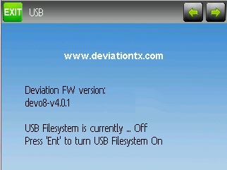

I have one Devo 8S and I have updated from version v4.0.1 to v5.0.0. But if I check the version I see it shows version v4.0.1 as you can see in the attached photo. I am wondering if finally I have v5.0.0 but shows v4.0.1 or really I have the old version.
The process I have done to update has been to delete all old files and add the new files of the new version including "hardware.ini" and "UPDATING.md" which were not in the old version.
Is there any thing wrong?

it looks to me you forgot to load .dfu firmware file within the zip with the Walkera DFuse and hit "upgrade" in the tool.

Thanks Thomas,
You are right, I did not load .dfu firmware.
