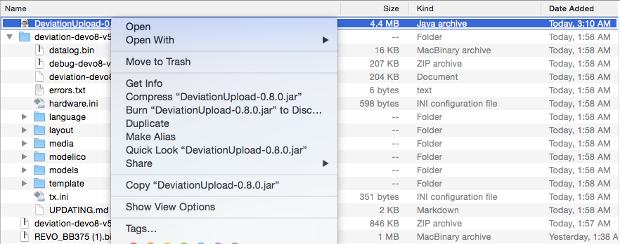

- run the jar file "using Jar Launcher" would be more specific. Double clicking the jar file decompressed it like double clicking a zip file does in OSX. You have to specifically right click and select open with Jar Launcher for it to act as expected. I'm guessing I have installed Jar Launcher in the past, or that it is part of a Java install, but I don't recall.
