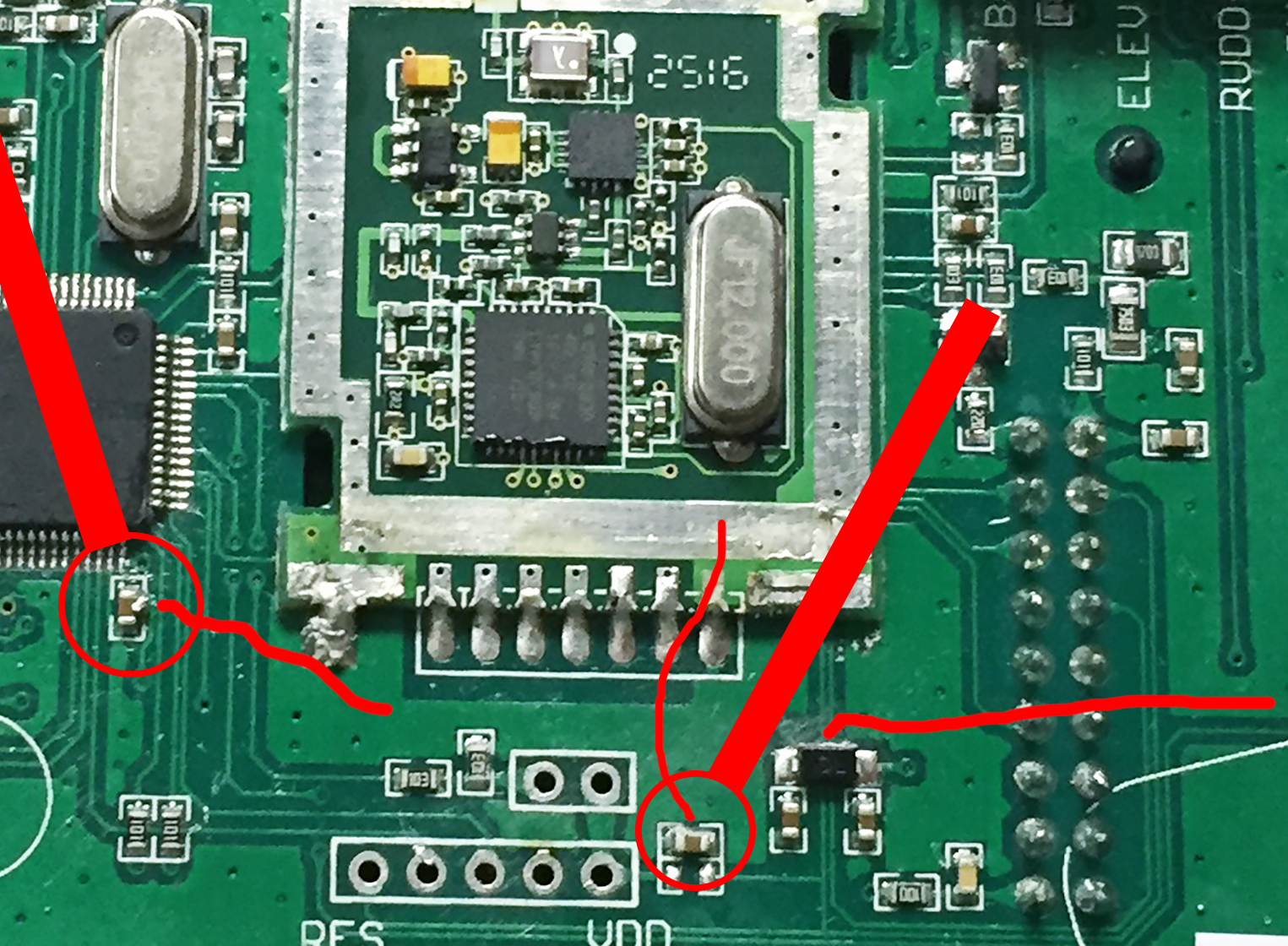

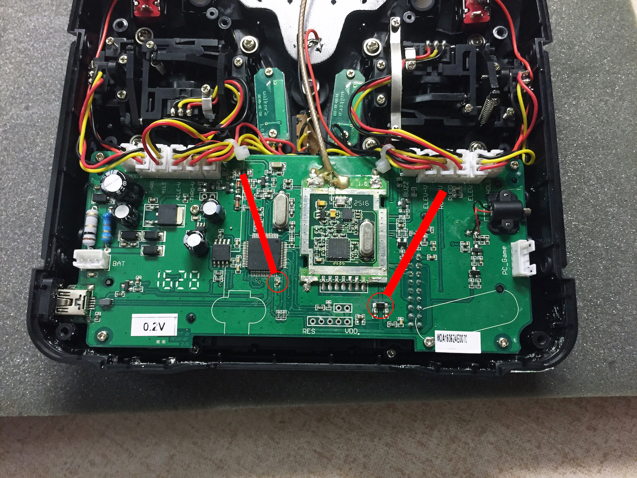

Hi, I have successfully preform range mode but accidentally shorten one or two smd resisotor/smd capacitor when turning on Devo 7e.
When I firstly turned on TX after range mod nothing happened (dead Devo) but then I have removed all solder which accidentally stick on smd resisotor/smd capacitor and Devo luckily turned on.
Everything seems to work okay but as I have already mentioned in the title USB is not working.
PC doesn't recognize my Devo and when I connect it to MacBook, MAC turn off automatically.
Is out here any possible way to fix that and make USB working again?

Oh man, as someone who's killed a [pretty high end] 15" Dell my wife was given from her work after a USB device I build shorted and back fed just ~6v onto a data line I can not stress enough that any time you solder stuff on a USB device that device needs to be tested in a powered USB hub before being directly connected to a computers USB port! Absolute max on a USB data line is just 5.85V! You really got lucky there, you have confirmed the USB port works on the computer (with a known safe device) right?
OK so your pictures show two shorted caps and I'm not sure what you're pointing the diode out for. That's a protection diode in the power line (5v) to the factory CYRF module, it probably doesn't have anything to do with your USB issue. Can you post a current pic now that you've removed the solder blobs? The USB data pins at the MCU are right next to the one shorted cap, I'd like to see pics to see you didn't simply damage the pins...

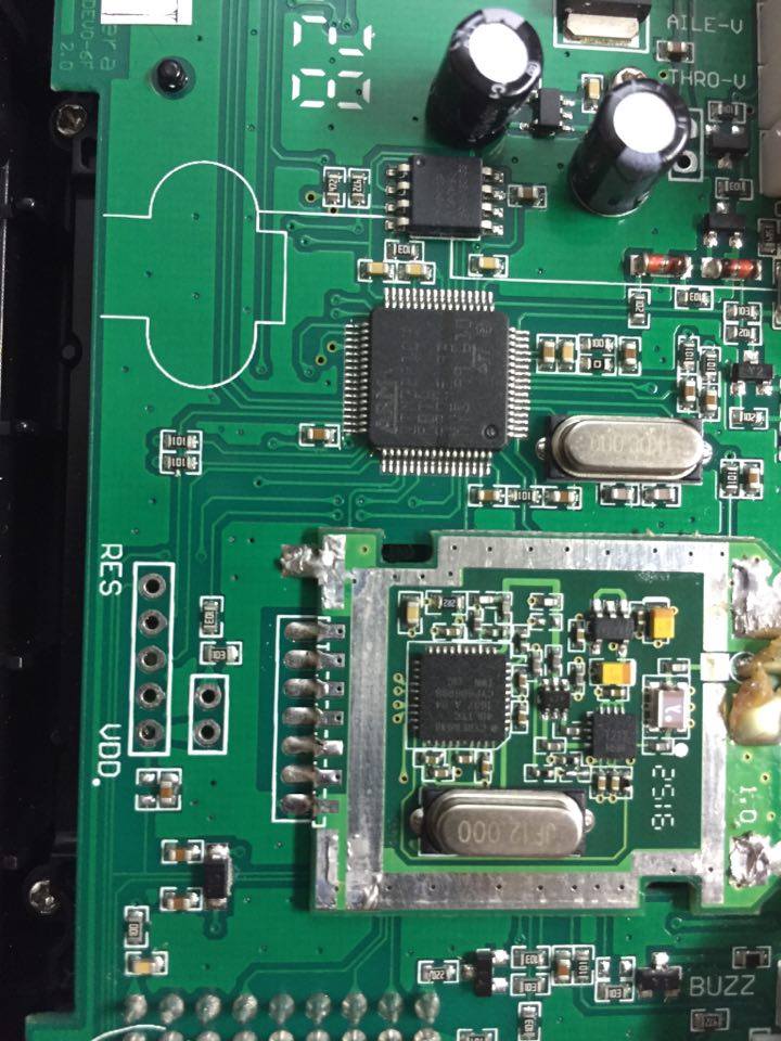

- mnb123
06 Feb 2017 11:25 #58813
by mnb123
Replied by mnb123 on topic Successful range mod but USB is not working/dead
I have attached latest photo. Do you need any more?
When I connect Devo to PC: "USD device not recognized" Before this Devo can connect to PC and MAC with no problem.
