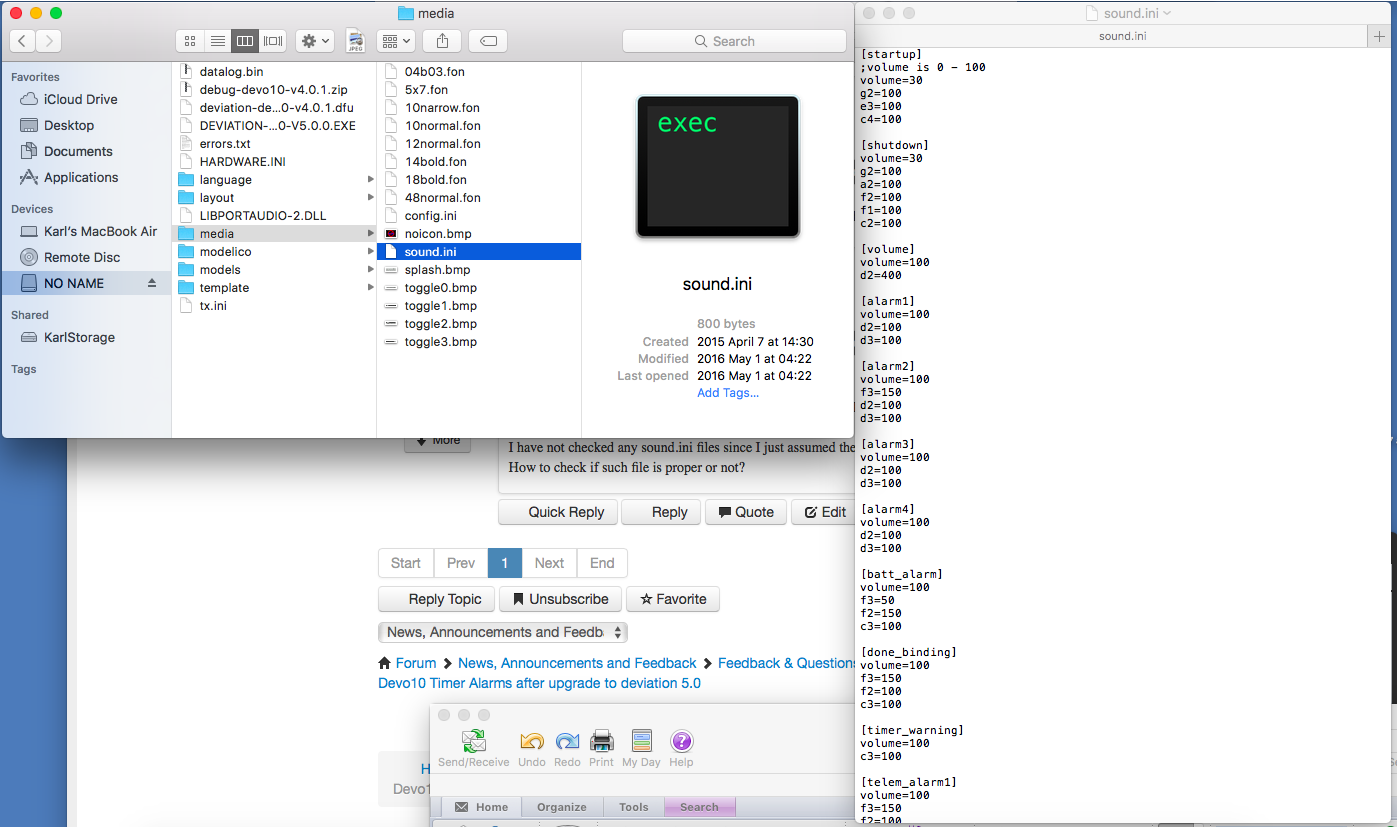

07 Feb 2017 08:46 #58861 by karla
Here is a screen shot of the file details and name and contents
Look very proper to me...
07 Feb 2017 08:54 #58862 by FDR
Looks proper.
Can you check the line ends if it is LF (i.e. Linux style as it should be) or CRLF (i.e. Windows style which is wrong)?
However is that the content of your TX's USB drive?
There shouldn't be zip, dfu, exe and dll files on the TX.
07 Feb 2017 09:14 #58863 by karla
oh,
Yes, if you look at the picture I uploaded I think all those files are there - to the way left.
Sorry I dont know how to check the LF at the end but I have uploaded the file here so maybe you can be kind enough to check for me?

07 Feb 2017 11:50 #58870 by FDR
The file is fine.
Try to recreate the filesystem from a fresh download, but don't forget to backup xour model files and icons...
You dont need to copy the zip, dfu, exe and dll files, but only the tx.ini, hardware.ini, errors.txt and datalog.bin file, plus the folders of course...
