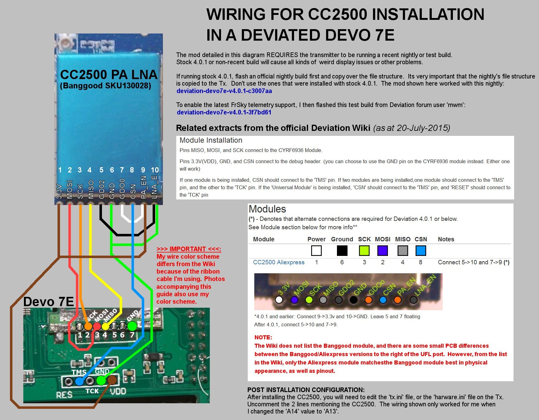

My devo 7e seems to turn off when it binds to my tiny whoop.. I own a frsky d8 furibee f3 flight controller and I have a modded devo 7e modded with the cc2500 module.ONLY. I have tried ALL of the nightly builds and the Version 5.0.0. everything seems to work find until I try bind to my flight controller. when I click bind it seems to bind but as soon as it binds the lights go off on my flight controller and on my devo 7e. I know it isn't the flight controller causing the problem as I have also tried to use an external ppm frsky receiver soldered to my furibee f3 flight controller with the same result but this time only the external receiver goes off not the whole flight controller. By goes off I mean it doesn't come back on until I remove the battery to my flight controller and plug it back in and my transmitter just reboots its self. I have tried different batteries with my flight controller and with my transmitter just in case there was a power issue. I have added a photo of the wiring diagram i used to wire the cc2500 module Sorry for poor grammar I have dyslexia.

Seems as if the wrong wiring on this picture will live forever.
Read the thread, the solution is probably there. ( GDO0/2 & Pa/Lna pins & Vcc/Gnd)
www.deviationtx.com/forum/3-feedback-que...modules-cc2500#57848 [/quote]

I'v tried that . The transmitter doesn't go off now but both the receivers go off when it binds :/ I'v even tried another quadcopter (210 size) with the same problem
