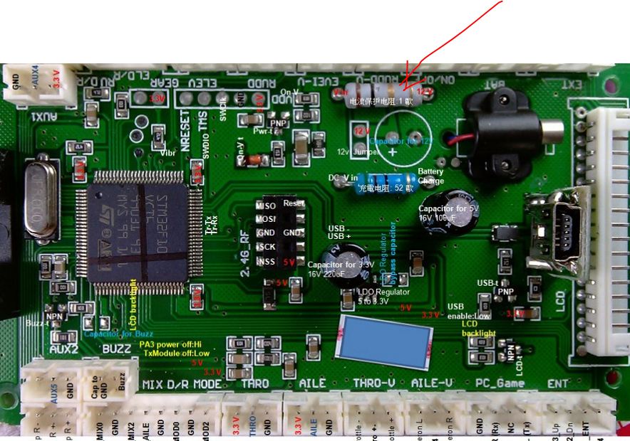

Thanks again! Yeah Iv read through that one, and anything else I could find on it.Last night I tried unplugging the module, didn't change anything. Tried jumping the switch a few different ways also didn't see any change. So I tried checking the board at different places for voltages.. This is where it gets weird, I'm probably doing something wrong. When I test with my multimeter the different places that show 12V and 5V and so on, on the pic(I'll repost it for reference), I get the same voltage reading with the battery in switch on, battery in switch off and battery out switch on and off. It seems to always show the right voltage everywhere I tested. Leads me to believe I'm testing things incorrectly.. lol. Anyway that's how far I got with it. Anything needing to be tested further than this will take a bit of explaining, and I guess I need to learn to correctly use a multimeter.
