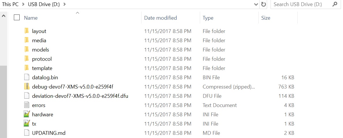

I have my F7 that I need some help with. I don't get any display information. When I power it on I don't get boot screen or Deviation. I know it's powered on and I can access the usb drive. Any ideas what my issue might be?This is the firmware I am running on it. XMS-v5.0.0-e259f4f

Probably your Tx filesystem is broken. Try to format USB drive and rewrite filesystem.

I just tried that an no go. Any other idea?

With emulator devof12e-XMS works fine. I can get empty screen only without filesystem. Can you try previus Nightly Build?

Well I used my other working F7's file system and it corrected the display issue I had. The default file system wouldn't resolve it. So strange. Thanks guys!
