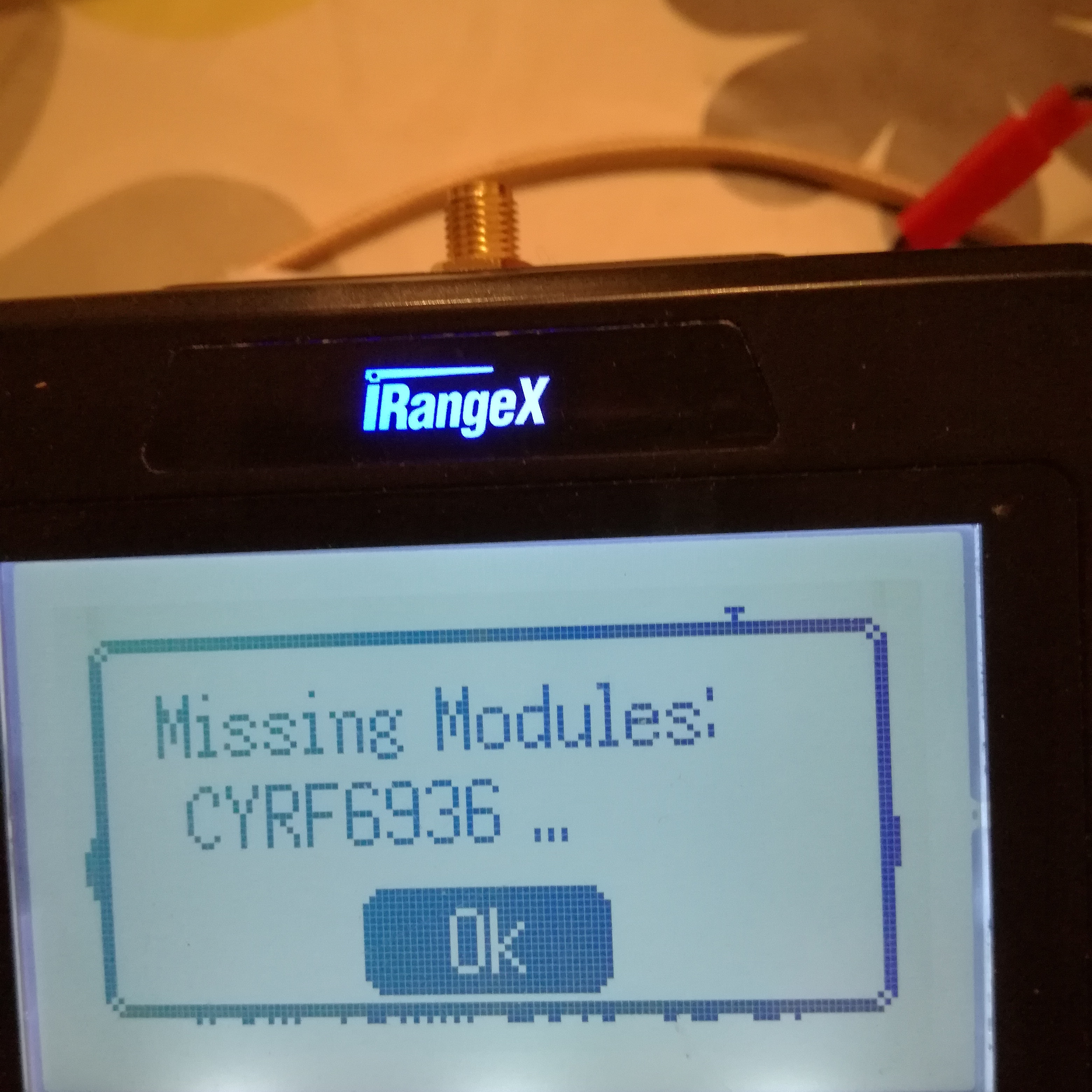

Je viens de trouver ça après la mise à jour

Try to change "hardware.ini", remove semicolon before "enable-cyrf6936" and set value = 0:
enable-cyrf6936 = 0
I saw this at general discussions. I might help you disable the message. Good luck.

Do you use the latest IR8M build?
www.deviationtx.com/forum/builds/7605-ir...uilds?start=60#68341
