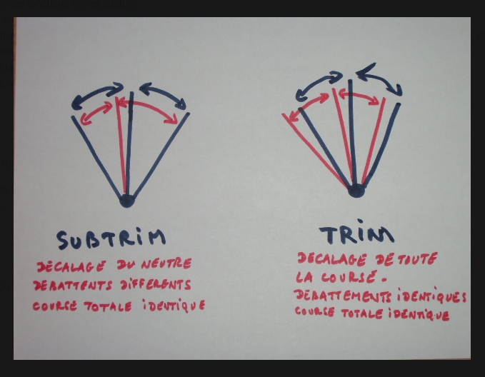

17 Nov 2018 16:55 #71776
by saidem
Replied by saidem on topic Subtrims or trimmers?
I understand your answer. I enclose a little diagram that I found on the internet. Finally, I do not know enough to say what is best, but I wanted to understand that deViation. Is this a disadvantage or a benefit the real subtrim?
Thank you very much for everything.
17 Nov 2018 19:49 #71780
Replied by FDR on topic Subtrims or trimmers?
OK, I see. In deviation it isn't implemented in that way.
It probably could be, but I don't know if that would provide any benefits...
