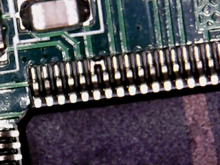

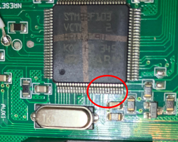

I found a short on 2 of the pins on the stm32f103 vtc6 chip. Could someone please tell me if they are supposed to be shorted? Could this be the problem?
I'm not sure the data sheet i found is correct but this one shows them being pins 19 VSSA and 20 VREF
Maybe someone has a Devo 10 open could take a peek and tell me if they are shorted on thiers. They are at the top left of the tx.
Thank you

Replied by hexfet on topic Devo 10 buttons and trims beep but do not function
Pin 20 is VREF- so it makes sense to be connected to Vss.
Will the tx boot into DFU or USB modes (EXT or ENT pressed at power-on)? That would indicate if those two switches are working or not.

Replied by vlad_vy on topic Devo 10 buttons and trims beep but do not function
Pins 19 and 20 are shorted on other Devo10 images.

Replied by Seven5555 on topic Devo 10 buttons and trims beep but do not function
I was able get it into dfu mode once and I updated the firmware to a nightly but the problem still remains and I haven't been able to to it again.
Thank you very much for the help
I see that now thank you and sorry I didn't find that until later.
