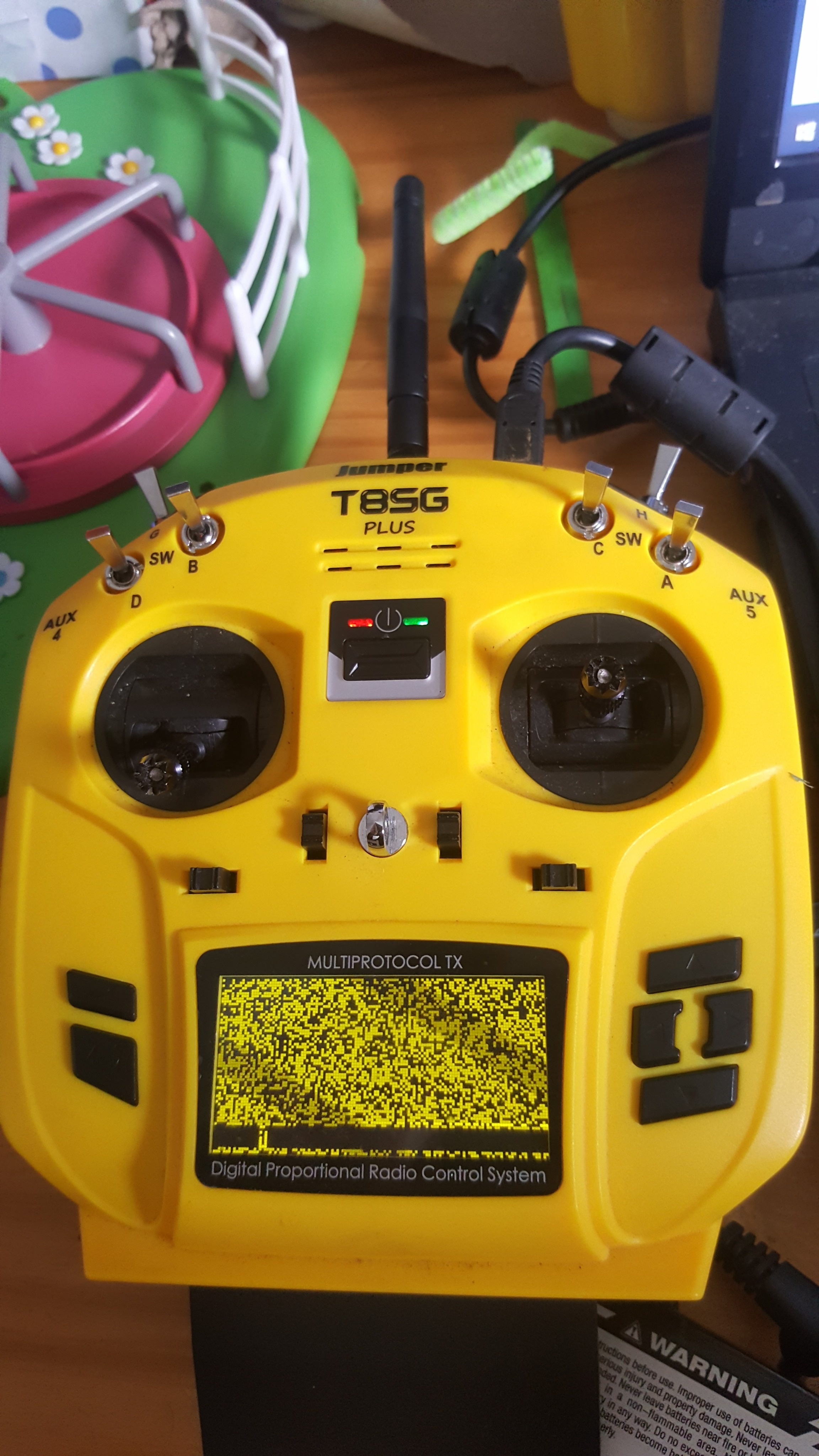

all setup and ready to go flying switched on my t8sg v2 plus and got a scrambled screen worked fine last time i pick it up. anyway tried to work out the issue i updated to the latest firmware and still have the same screen fault anyone have any ideas i checked the ribbon cabble all seems fine. i think it might be a mainboard issue.
can i buy a replacement mainboard ???

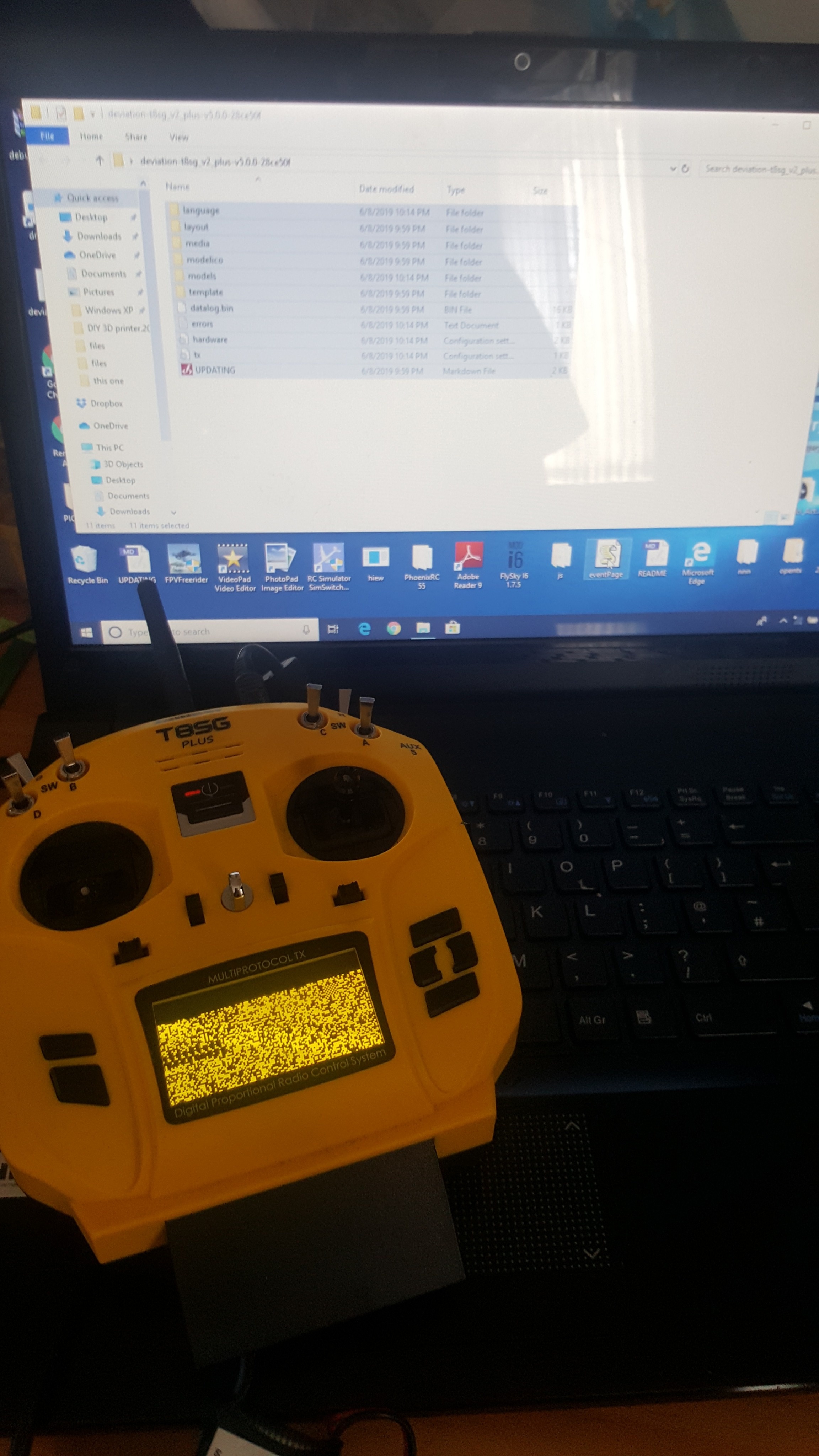

Try to use USB mode (Press ENT button and short press Power On). If you can see USB symbol, then format transmitter USB drive and copy filesystem from firmware archive.
- Whik123
- Posts: 10
08 Jul 2019 10:25 - 08 Jul 2019 10:43 #74711
Replied by vlad_vy on topic Jumper t8sg plus v2 display fault
I don't understand, can you see USB symbol on screen when you activate USB mode? If you see it, then LCD is OK.
For me, it looks like LCD memory damage. Will be better test this LCD with different T8SG V2 Plus.

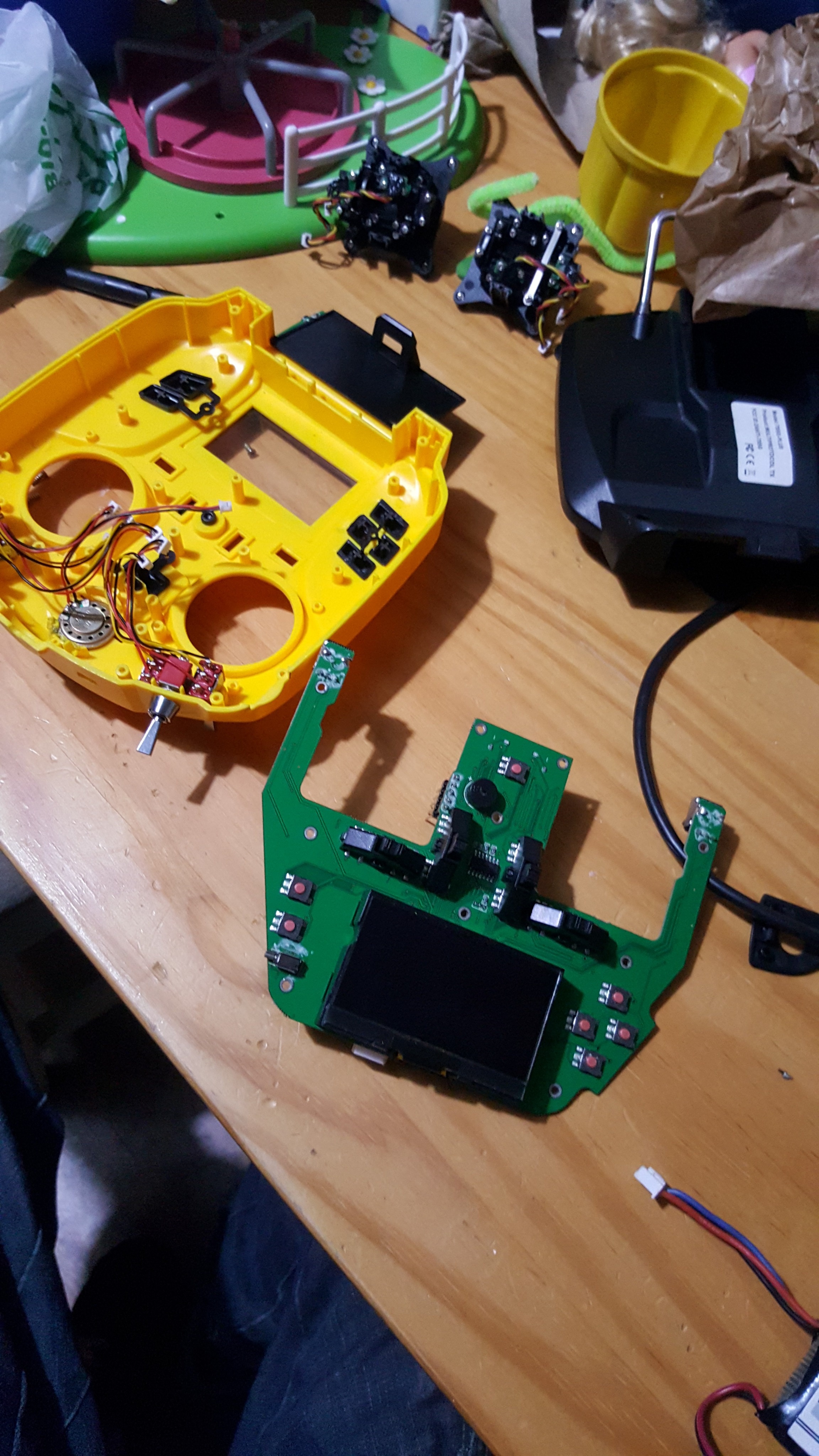

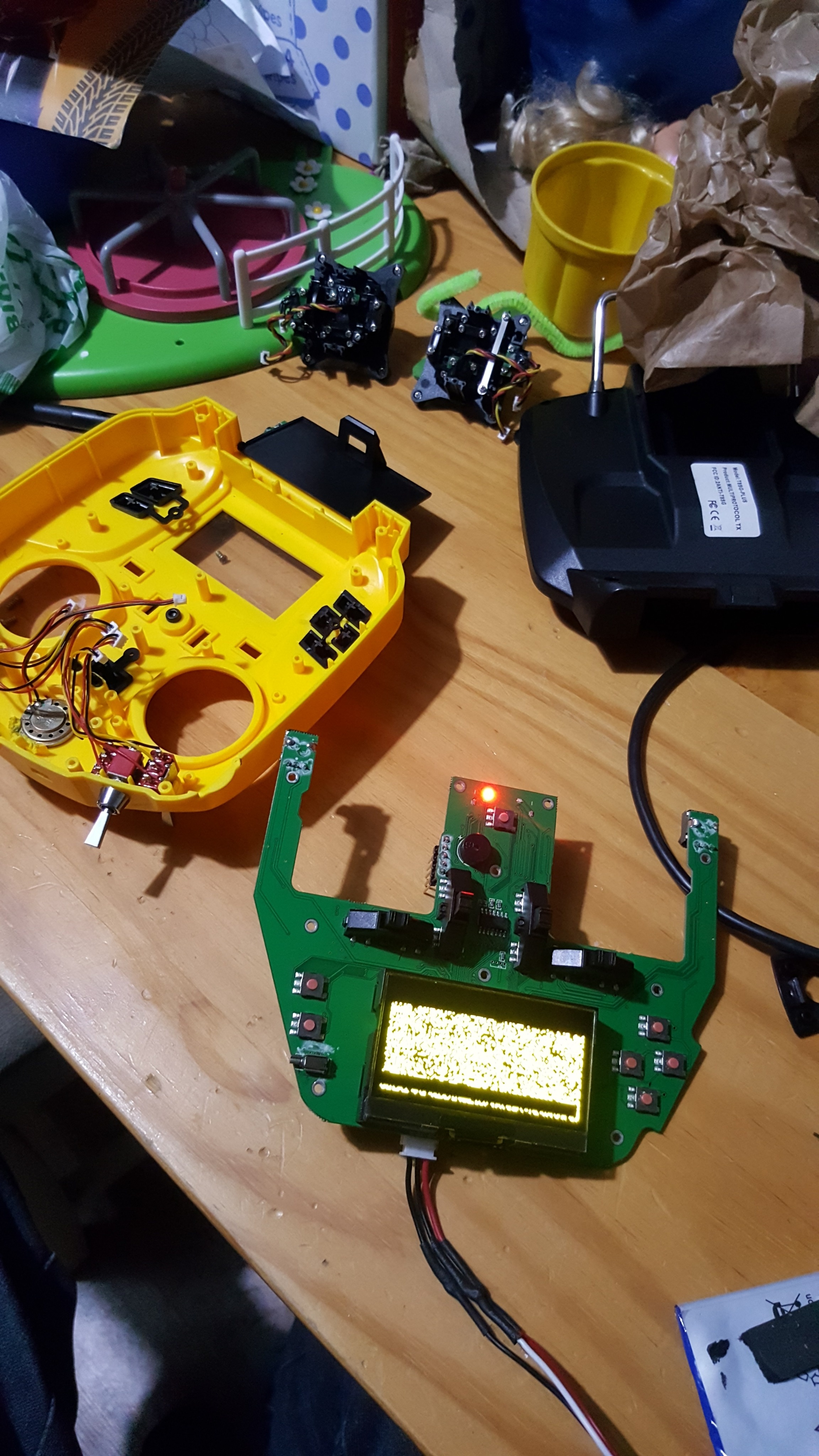

Something wrong with LCD.

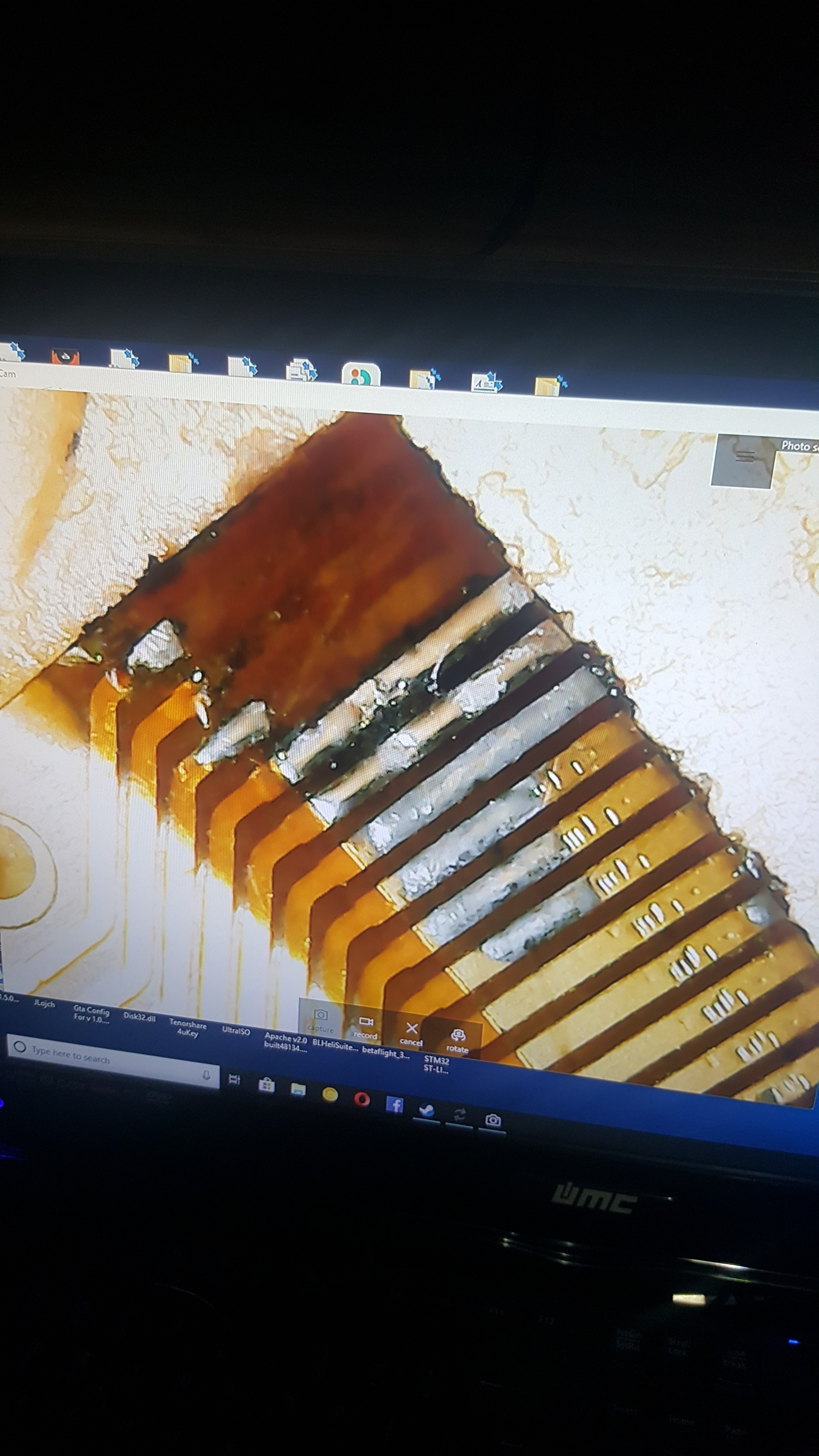

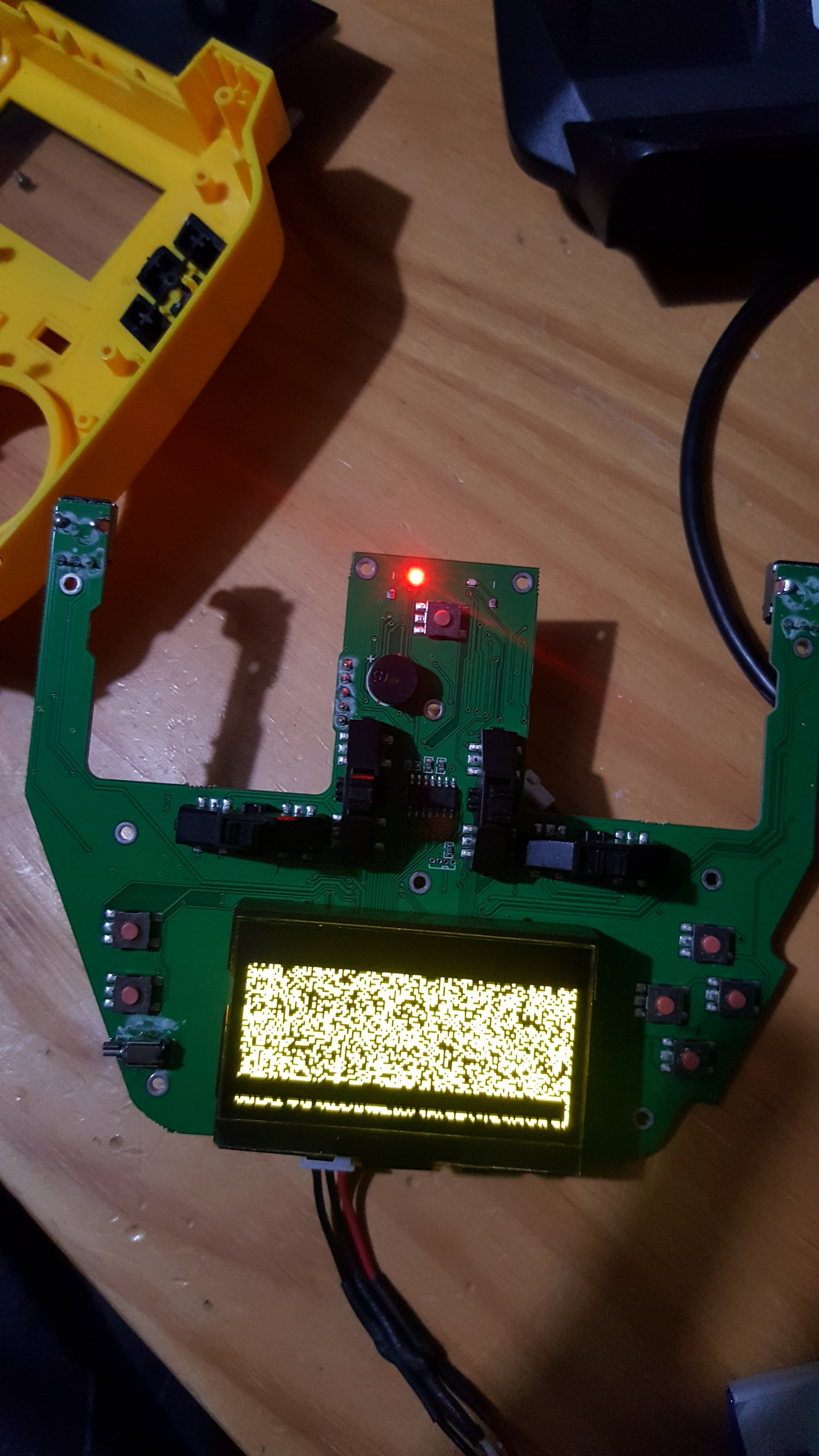

Smart guy thumbs up thank you it was just a broken track on the ribbon my repair attempt just made it worse
is there a replacement screen avalible anyware
