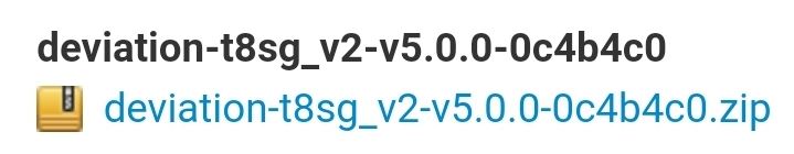

20 Jan 2020 11:47 - 20 Jan 2020 11:48 #75776
by mstansfield001
Replied by mstansfield001 on topic t8sg v2 plus Blanc screen after firmware update
Last edit: 20 Jan 2020 11:48 by mstansfield001. Reason: Spelling
