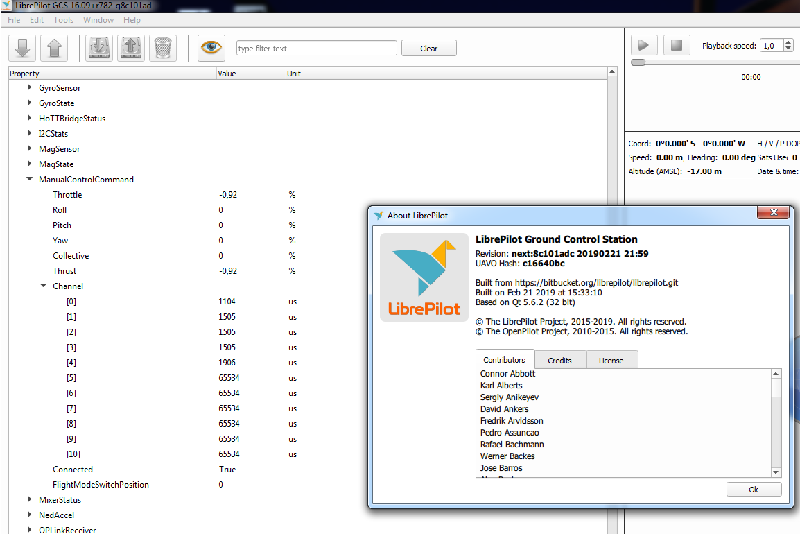

Hi!
I paired it my Openpilot Revo Board with a Walkera RX1002 (Devo 10 transmitter - PWM). Everything works fine except that it does not detect Revo the RX turning off.
"Data Objects>ManualControlCommand>Channel>Cconnected" stay "True" after the transmitter swithed off.
If I turn off TX, the all pwm signal levels remain in the last state. When I unplug the RX1002, the Revo sense the signal lost state, switch to "False" state.
Does anyone have an idea?

Replied by vlad_vy on topic Failsafe - Devo 10 / Rx1002 / Openpilot Revo
Devo hasn't "No pulse" option for failsafe, so you need set up failsafe values at transmitter. Switch channel failsafe state to "Fail Safe" and set desired failsafe value, repeat it for every channel. If you use Deviation, set failsafe values at Mixer channel properties.

Replied by Wregwreg@gmail.com on topic Failsafe - Devo 10 / Rx1002 / Openpilot Revo
Thank You. I tried Tx failsafe, it works, but I wanted to use Flight controller failsafe.
DEVO 10 don't know the "no pulse" option or just the RX1002?
Devo protocol don't know the "no pulse" option. Probably RX1002 also don't know the "no pulse" option.
