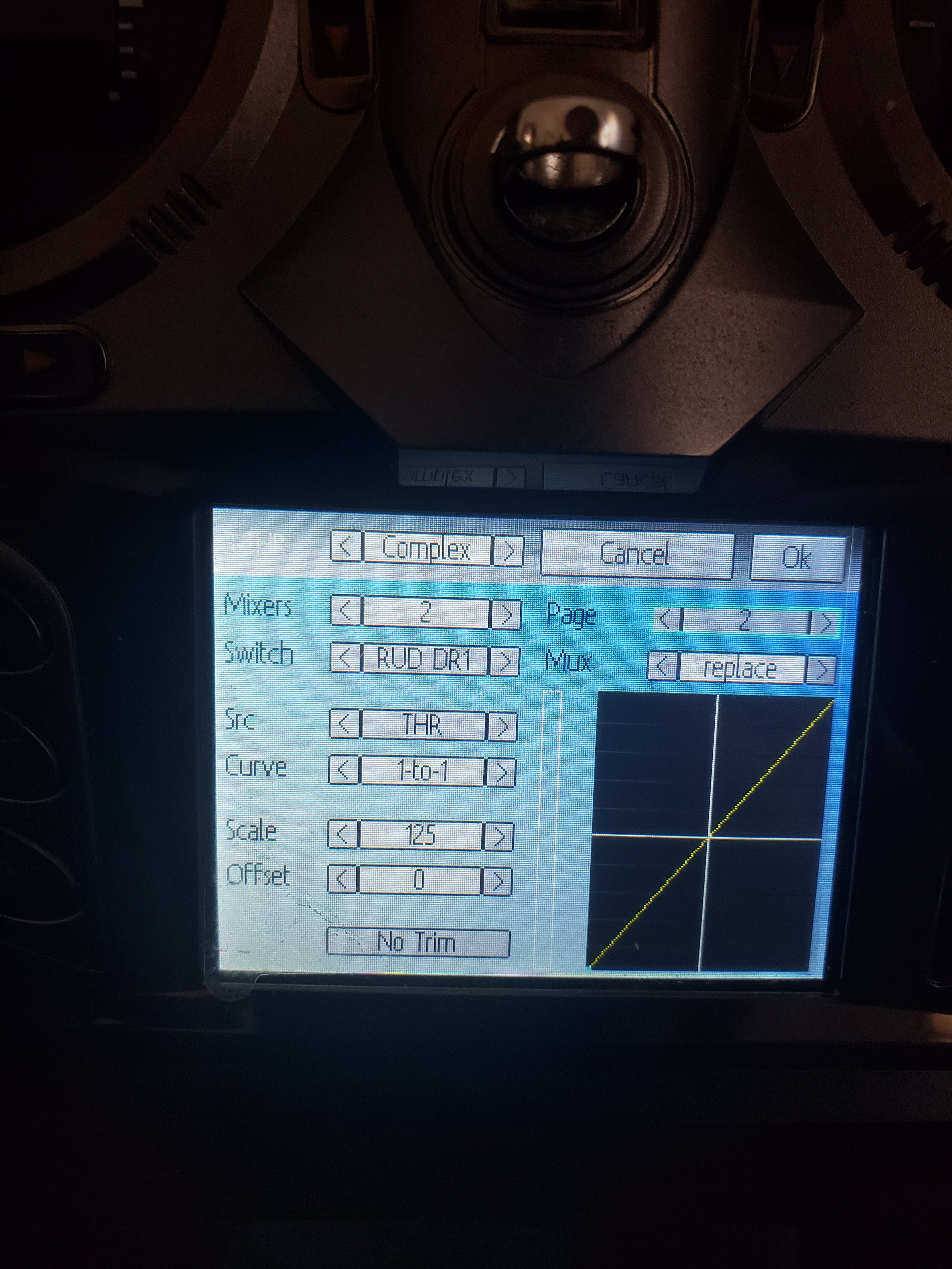

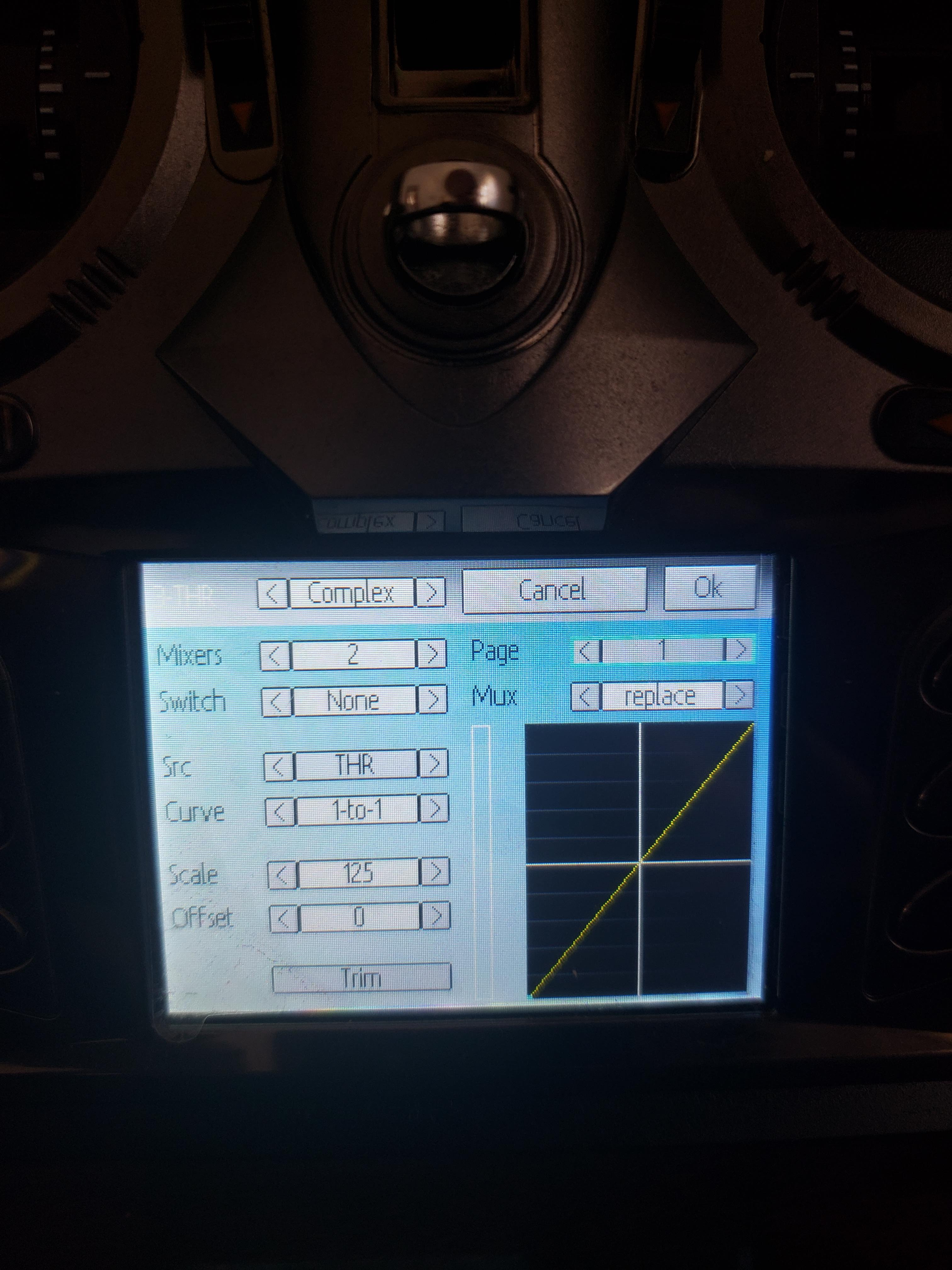

Hello, i tried both models and nothing work as expected
... But what if I try to change the throtle mix and make it complex with 2 mixers as shown in the images below? What gonna happen?

I do not understand the sense of the complex mixer. With the switch Rudd_DR the same signal is sent from the same source to the same TX channel. What should happen by switching Rudd_DR?
Another hint: In the first video I saw that the trim for the gas channel is in the middle. Please adjust the trim to the bottom and the scale for the Thr back to 100%. Then try if the rear engine starts and stays running.

Just noticed the scale of your thr ch in your pics is 125, why?

Default settings downloaded from .ini of 180 q2 model

Not from the link I posted, can't possibly be.???
edit: Should probably be 100, as should all channels.
