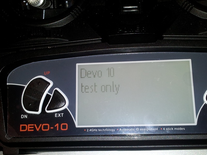

Here is the picture of the test version
It is a good start. But I just want to have the option to flash back Walkera's firmware before a workable deviation version of devo10 is released.
Thanks in advance
