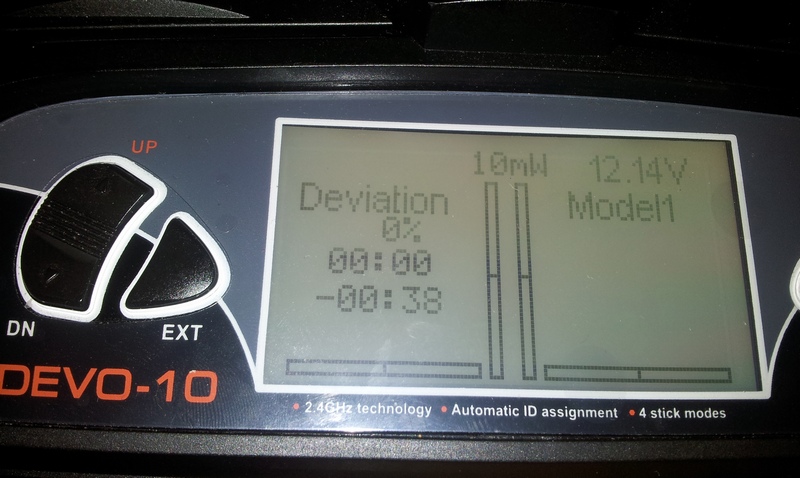

I coded the main page for devo10, it works fine with emulator. However, after I had codes flashed to real devo10 devices, it doesn't respond to key press, e.g. the timer1 should start /stop when UP is pressed and should reset when Ext is pressed. In addition, the throttle value is not updated in the main page screen.

After more test, I found only the buttons connected to PORTB.GPIO4(UP,DN and Ext) don't work, all other buttons work properly.
So I tried change codes related to B.4, I got no good result yet. Any idea from PB and xC?
And I have a question about why the B.5 pin should be set to 0 instead of setting to 1 as B.4/8/9
gpio_set_mode(GPIOB, GPIO_MODE_OUTPUT_50_MHZ,
GPIO_CNF_OUTPUT_PUSHPULL, GPIO4 | GPIO5 | GPIO8 | GPIO9);
/* PB.4 = 1, PB.5 = 0, PB.8 = 1, PB.9 = 1 */
gpio_set(GPIOB, GPIO4 | GPIO8 | GPIO9);
gpio_clear(GPIOB, GPIO5);

Finally got the issue solved, it is caused by conflicting with the SPI touch which uses the PB.5 pin as well. So the main() function should conditionally comment out functions related to SPI touch for devo10
