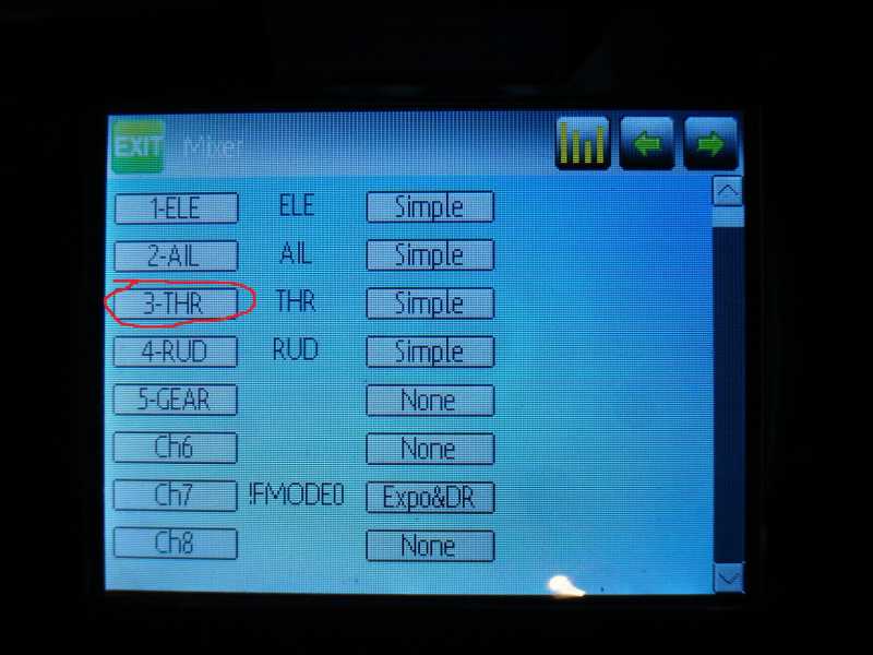

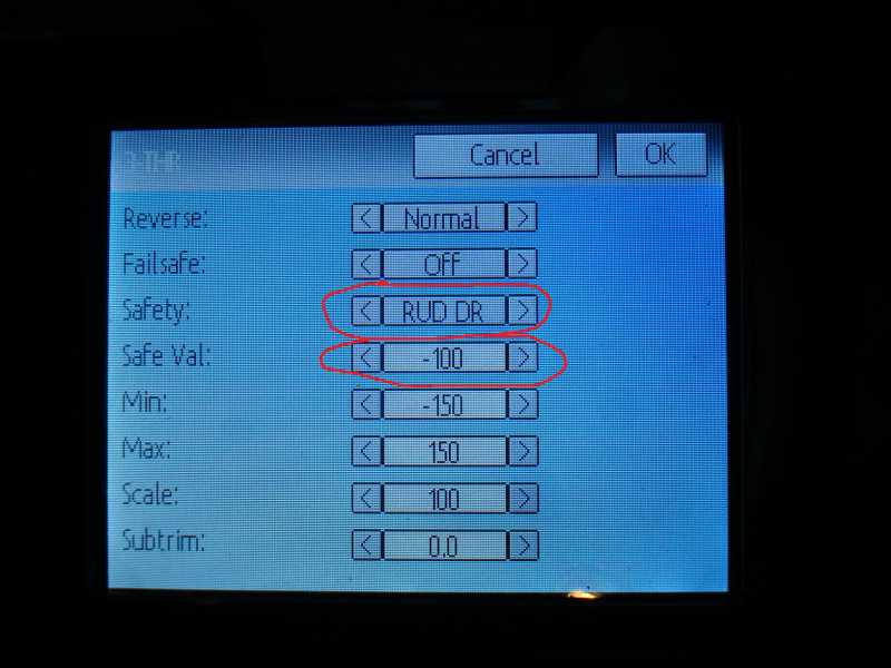

Complex mixer - example at last page of User's Manual (page 21), page 4 of complex mixer, for 'Throttle Hold' used 'GEAR' switch.
Channel configuration - (page 14), Safety: [switch], Value: -100%.

11 Oct 2012 05:50 #2155
by flint723
Replied by flint723 on topic How to enable throttle hold in current devo8 build
