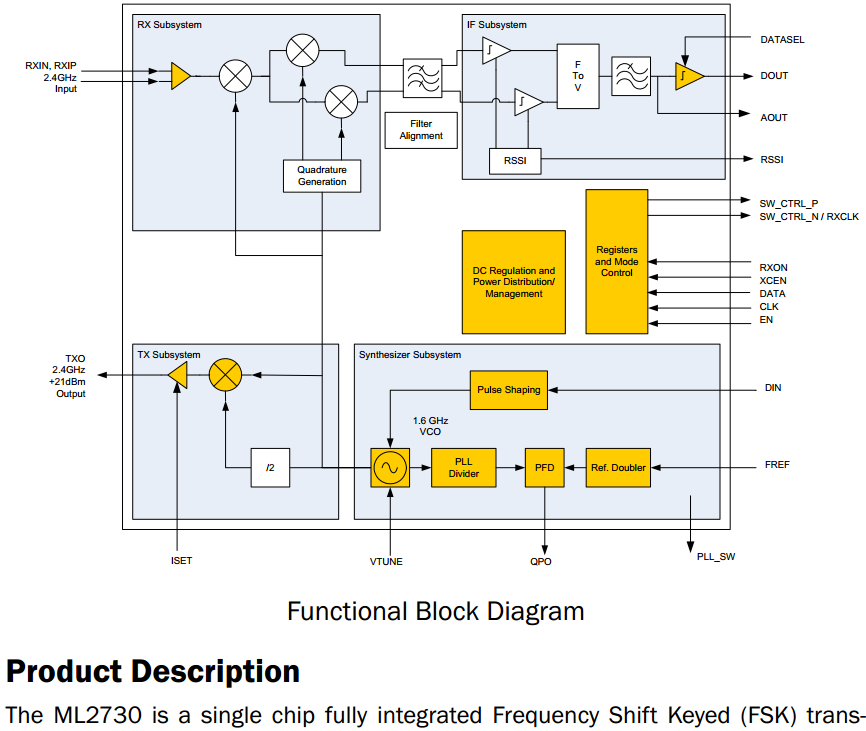

I looked up the ML2724 (RFMD site is a mess) The part has a 2003 date on it, lacks an integrated base-band engine, which would suggest the part has been superseded by newer and better parts. The "not recommended for new designs" stage should have passed many years ago.
There should be no reason to use this part unless you need compatibility with old equipment, which may be the case why Futaba uses it in later products.

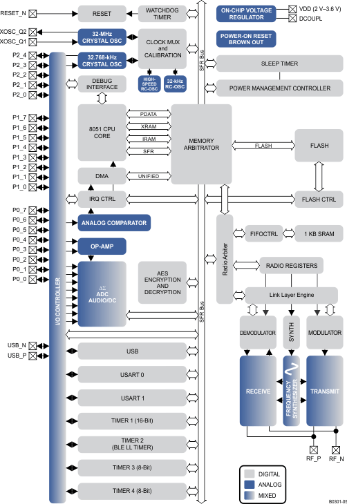

ML2730 also lacks a baseband engine. This antiquated part (2009?) "only" contains RF-modulation and de-mod sections, and is way behind the curve of other SoC-parts that also include base-band engine, USB, SPI-interface, AES en/decryption and integrated micro-contoller and other stuff.
It does have a 20dBm PA and may well be a nice part, for its era, but any new design would clearly leave it in the dust, and I would consider more recent designs, like www.ti.com/product/cc2540 with a CC2592 25dB range extender, and others.

"ML2730 also lacks a base-band engine."
This may be the reason Futaba has a branded chip to interface this this part?
Alone the ML2730 can't do anything.
