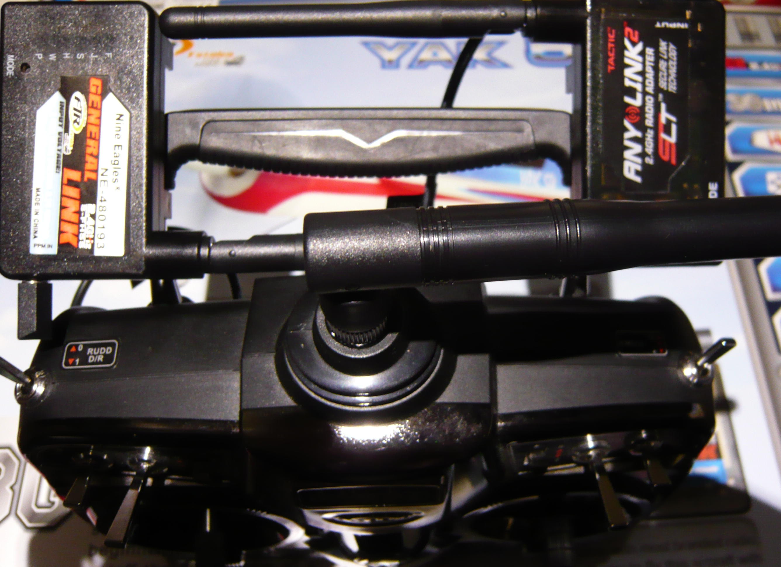

24 Nov 2014 23:12 - 26 Nov 2014 00:04 #26563 by Schugy
Replied by Schugy on topic nine eagles?
My Yak responded immediately to my new General Link module.
I hope this helps you to avoid my error.
EDIT:
Nine Eagles offers at least 3 different General Link modules:
NE480133 DSSS to replace J4, J5 and J6 transmitters (not necessary with DeviationTX)
NE480193 S-FHSS for models with Futaba Code receivers.
NE480192 for SLT.
The NE480114 module seems to be outdated.
Last edit: 26 Nov 2014 00:04 by Schugy.
