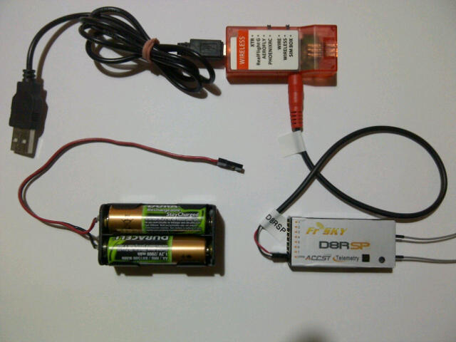

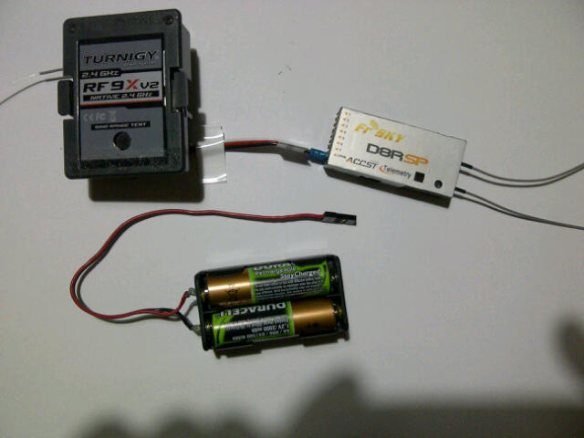

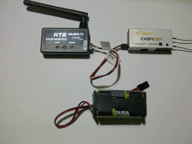

Currently off a 9x modded FrSKY I am doing as per pics, this works extremely well. I can fly my FBL100 3D copter with the HT8, I can fly the V911, V929, V939, X9958 off the turnigy module and some small parkfliers in close proximity, placement of the setup is careful in these two cases for good reception to the models being flown, and lastly the wireless sim works extremely well this way as well. This way nothing extra is physically plugged in the tx ppm out as I am using the rx's one
I was hoping to move the setup over to the Devo8s but I am sure not too far away the FrSKY module support will be added to the Devo's, till then I will wait patiently, unless I find a compatible rx sooner
This method can be hacked for many different tx modules & similar uses as you can see. I doubt for everyone but works great for me.
