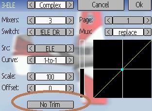

I put in a mix on my elevator to compensate for flaps. with dual rate elevator, this made 3 pages.
I noticed with this config, elevator trim quit working.

- Hexperience
- Posts: 588
28 Dec 2012 20:18 - 28 Dec 2012 20:19 #4340
by Hexperience
Replied by Hexperience on topic elevator trim quit working going to complex mix
Last edit: 28 Dec 2012 20:19 by Hexperience.
- jdowdle
- Posts: 18
28 Dec 2012 21:08 - 28 Dec 2012 21:09 #4345
by jdowdle
Replied by jdowdle on topic elevator trim quit working going to complex mix
thanks, that must have defaulted when I went to complex. did not even notice it is an option. that's my excuses. thanks again. now I can complete that setup.
