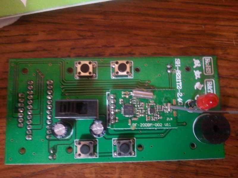

The DH9116 TX can be used to fly a v911. Since Devo 10 can control V911 with modification from the V911 transmitter. I was wondering if you could take from the DH9116 TX and add it into the Devo 10 TX. That way controlling a V911 and DH9116 all with Devo 10 tx? I am new to this so I hope the question is understood. Thanks so much for all yall have done with this. I thoroughly have enjoyed it.

Open up your DH transmitter and post pics. Most likely there is a module you could take and install in your Devo 10. Keep in mind it might be the same module used by the v911 TX.
But, we can't know until someone 'volunteers' to take some pictures. Good luck.

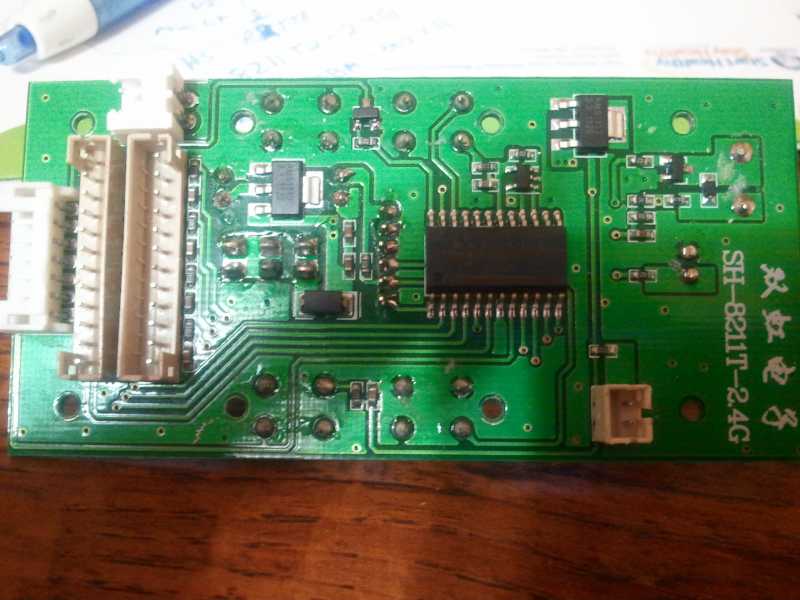

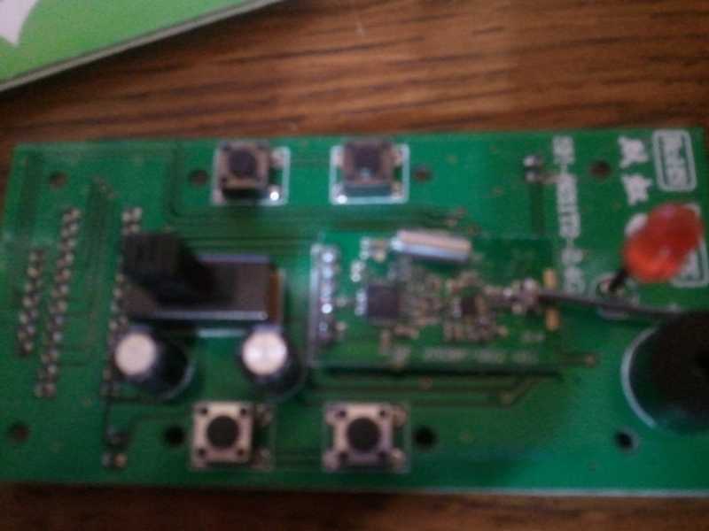

Thanks...I took some pictures. I hope these are pictures of the part. I tried to get the pictures as clear as possible (using a cell phone camera). The big board is labeled SH-8211T2-2.4G. The smaller board on the back of that board is RF-20DBM-002 V11.

The small board is the module and it looks very very similar if not identical to the v911 one. You can desolder and transplant in into your Devo 10 as seen in my thread found in the How To section of the forums.
Try to put more pictures after you de-solder it :)

If you have a solder suction syringe or wick it will be very easy. If not, try to heat up the pins all at once and remove the module when the solder has melted. It's only 6 pins and a 30W soldering iron should do it.

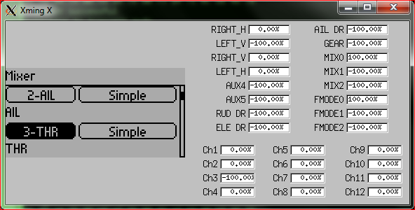

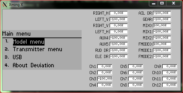

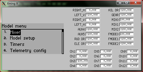

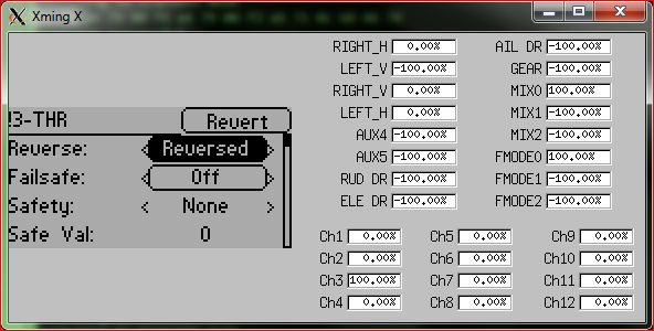

I don't have the DH9116, but it looks like THR and RUD may be reversed.
Go to mixer, select THR, press ENT and on Reverse switch Normal to Rversed and try again.
PS: found a lot of DH9116 owners having tail issues when binding to non-stock TX.
