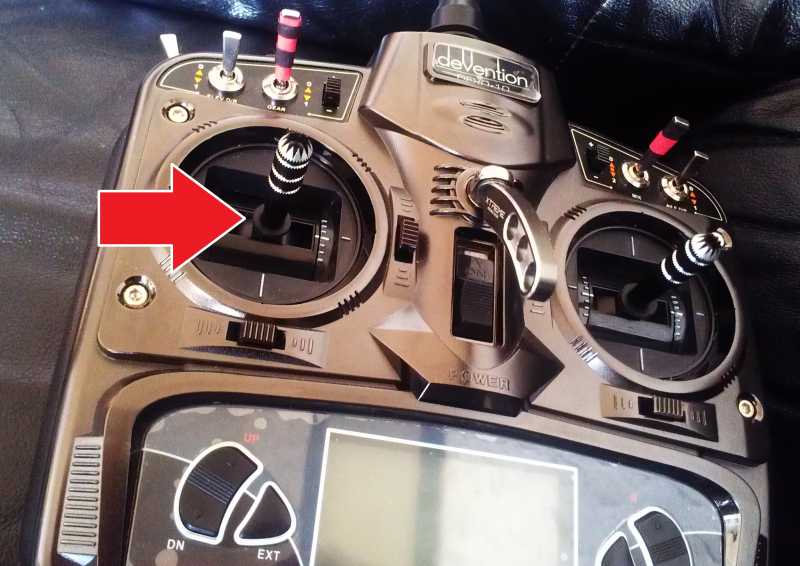

Hi!
I ended up grabbing a pair of Spektrum stick ends made for Dx8 and Dx6i, as they seemed easier to come across.
They fit perfectly, thanks to your info!
I added some rubber washers between the new metal knobs and the threaded m3, then tightened up the stick ends. After recalibrating the sticks, I now have smooth end points instead of stock thud
Let me know if you'd like to see a pic!

Replied by rbe2012 on topic compatable Tx upgrades?
My English is not good enough to self-produce an imagination of where you have placed the rubber... so a picture would be nice.Scream wrote: Let me know if you'd like to see a pic!

Replied by Scream on topic compatable Tx upgrades?
Hiya!
Pictures are worth a thousand words so... behold my baby!
...Pretend there's a blue led behind the devo10 part... that's next on the list!
Cheers!
-=S=-
