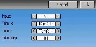

Hi mate. Well on deviation, can you reverse trim directions without reversing the direction of the stick that the trim is associated to?

10 Mar 2013 14:48 #7609
Well, you can reverse the trim buttons...
Replied by FDR on topic Devo 12s reverse trim switches
Hexperience wrote: No, trim works in the direction of the channel. + is + and - is -.

- gmcquet
- Posts: 28
10 Mar 2013 15:57 #7613
by gmcquet
Is this only in Deviation? Can you reverse trims with stock firmware?
Replied by gmcquet on topic Devo 12s reverse trim switches
