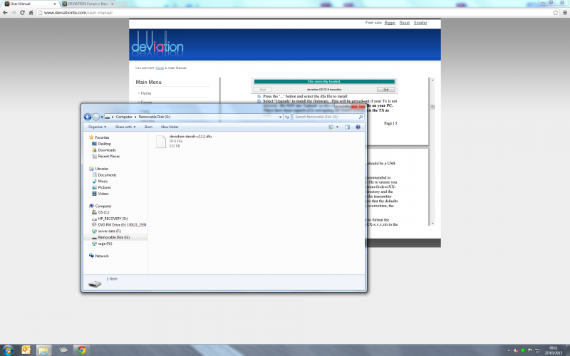

Hi guys, Sorry to be a pain. Wonder if anyone can help.
I upgraded the firmware from walkera website to the latest firmware 1st of all
using the DfuSe USB Upgrade’ tool.
Next I left DFU mode and shut down TX. Started it up and all worked.
Next i downloaded the Devo 6 Version 2.1.1 file and unzipped it.
I Opened Dfuse upgrade tool and upgraded the firmware then left DFU mode and shut down.
I then started TX in USB mode - I unzipped the Devo6 version 2.1.1 file to the TX and it asked me to format so i did and then saved the DFU file to the USB.
But now I just have a flashing screen. When i start in USB mode i have no file structure just the Devo6 DFU file.
Some help please.
thank you

You need to copy the filesystem over once in USB mode.
Download devo8-fs-xxxxx.zip from here:
deviationtx.com/repository/Deviation-Rel...fs-devo8-v2.1.0.zip/
Unzip the archive then copy the folders inside to your USB drive.
Filesystem should look like:
Leave out the filesystem/devo8 part. Copy individual folders + tx.ini only.
Good luck.

Thats awesome,
All sorted now and working.
Any models I need to copy into the TX i cpy into the models section on the USB then
