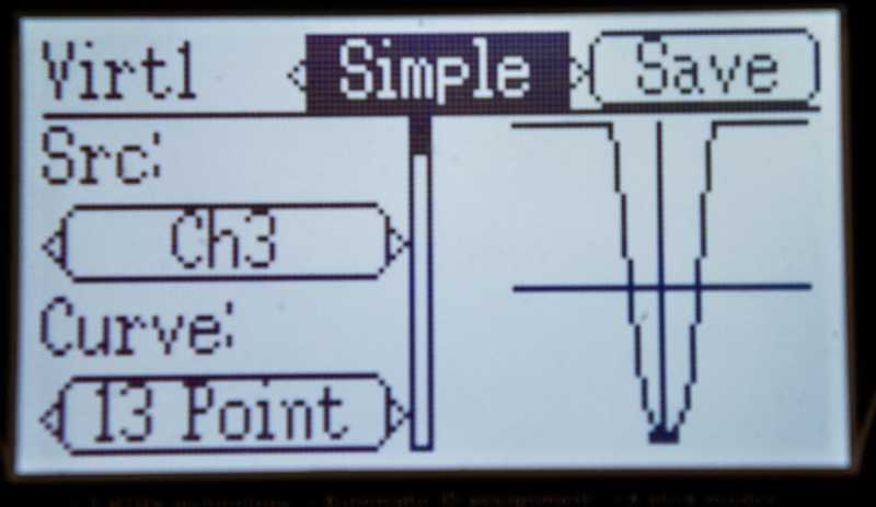

with the mixing page on the photo, can someone please help to point out what is wrong with my expection below:
I want to create a Virtual 1 channel that:
1, when my Tx outputs a -100% on Channel 3 to my receiver, Virtual 1 should give a value of +100%
2. when my Tx outputs a 0% on Channel 3 to my receiver, Virtual 1 should give a value of -100%
3. when my Tx outputs a +100% on Channel 3 to my receiver, Virtual 1 should give a value of +100%
It is no doubt that my expection is wrong cause it doesn't beheave that way.

What is wrong? All looks fine. If you want to use Virt1 channel for output, you need use it as a source for real channel. For example: Ch3 - Src:Virt1, Curve:1-to-1.

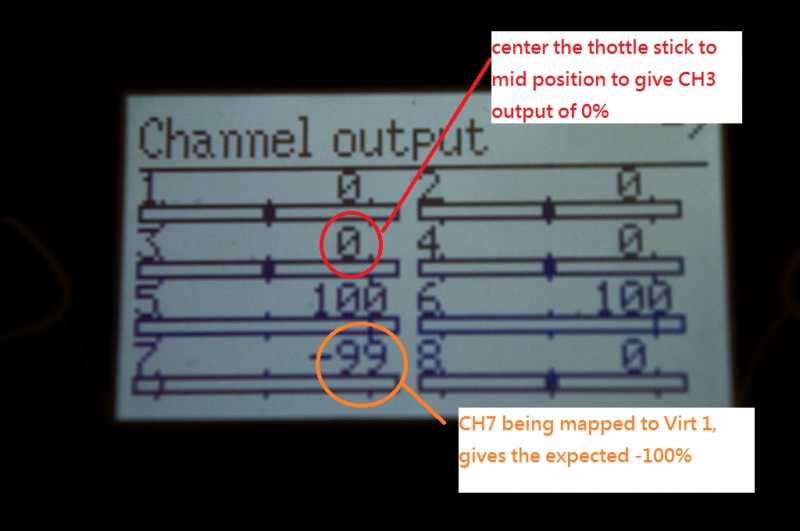

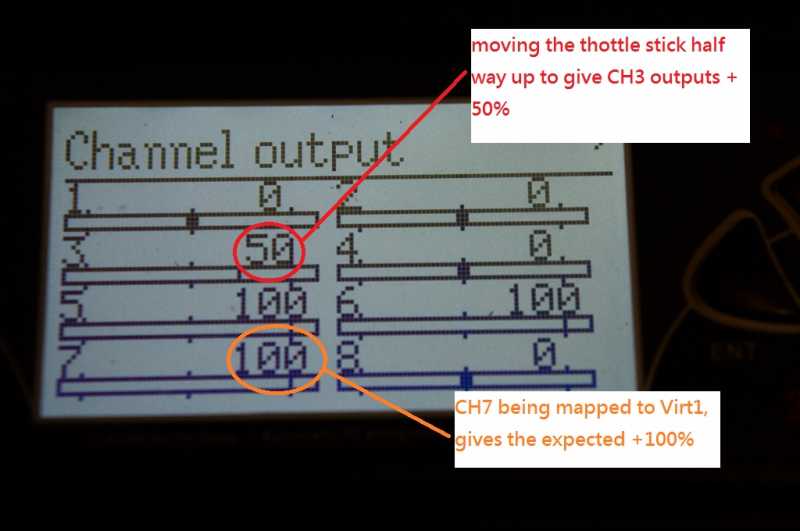

04 Apr 2013 06:23 - 04 Apr 2013 06:40 #8486 by cmpang
Replied by cmpang on topic Confused by the mapping logic
vlad_vy wrote: What is wrong? All looks fine. If you want to use Virt1 channel for output, you need use it as a source for real channel. For example: Ch3 - Src:Virt1, Curve:1-to-1.
Actallly I used CH3 for thottle control.

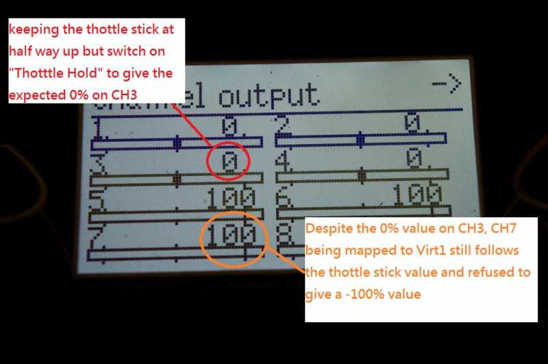

I works when I move the thottle stick, but as you are aware, I also use a switch as "Thottle hold" to held up the thottle to 0%. So under Thottle Hold condition, shall I expect Virtual 1 to give a fixed value of -100%?
The fact is Virtual 1 still follows the stick movement disregard the hold switch.

I believe for ch3 you use the throttle stick as input and the throttle hold switch. So the output ch3 is dependent of the throttle stick (-100 to 100) and the th switch (assume -100).
This is used as input for virt1. So if you have an input of -100 you will get +100 as output regardless if the input is created by the switch or because the throttle stick is down.

I assume this is because you use the safety feature for the throttle hold, which is applied after the Ch3 value is calculated, just before the tx sends it out (just like the reversing and the subtrims for example).
If you used a complex mixer page for the throttle hold, it would work...
Other option would be to use a complex mixer on the Virt1, and implement the throttle hold switch there on a new page...

As I've already told, the safety value is not reflected in the ChX values, because it is applied after that calculation, and effect only that channel, which it belongs to...
Don't let the box and bar values fool you, because they also apply some of those values, like the safety for example, while they don't apply others, like for example the reverse is shown on the channel monitor, but not on the main page bars and boxes...
So please try to implement the throttle hold with a complex mixer, and see if it solves the problem.

As FDR mentioned ch3 is a virtual value which is not send out to the rx. There are some operations applied to it before the tx will send the value out like the safety switch/value.
You will see the difference when you compare the channel monitor with the real heli / plane.
Suddenly I am not sure about this.
I tested it again and the emulator shows that the ch3-value shown in the channel monitor (or as a bar) IS dependent of the safety switch. It shows a constant value if the switch is applied.
Nevertheless the virtual channel is fully reacting on the throttle input. So obviously it makes a difference if you show a channel value on the display (regardless if as bar, in a box or in the channel monitor) and if you use it as input for another channel (esp. safety is not applied).
So you can't use safety in this case. As I have done above and FDR supposed using a complex mixer and an additional page with the th switch works.
