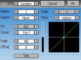

I have search thru the manual and did some search in the forum, cannot find how to map a switch to change the FMODE.
Currently the SW labeled AIL-D/R change the FMODE to FM0 and I wish to map it to the FMODE SW

If interface = 'Standard', at 'Switch assignment' page select switch for 'Fly mode'.

Possible I incorrectly undestand your question and you only want remap icons assigned to swithes and displayed at main screen?
You can do that at 'Main Page Config', change 'Toggle1,2,3,4' switch and icons.

Oh....I think i found out what is my problem.....
The ICON for AILE-D/R is mapped to "F0" (by default??) but I m trying hard to remap the switches.....
re-assign the the ICON solved my stupid problem.
Thanks anyway.

vlad_vy wrote: With Advanced GUI you can do almost all you want. You need select other switch at all mixer pages that use FMODE change.
Thanks anyway.
