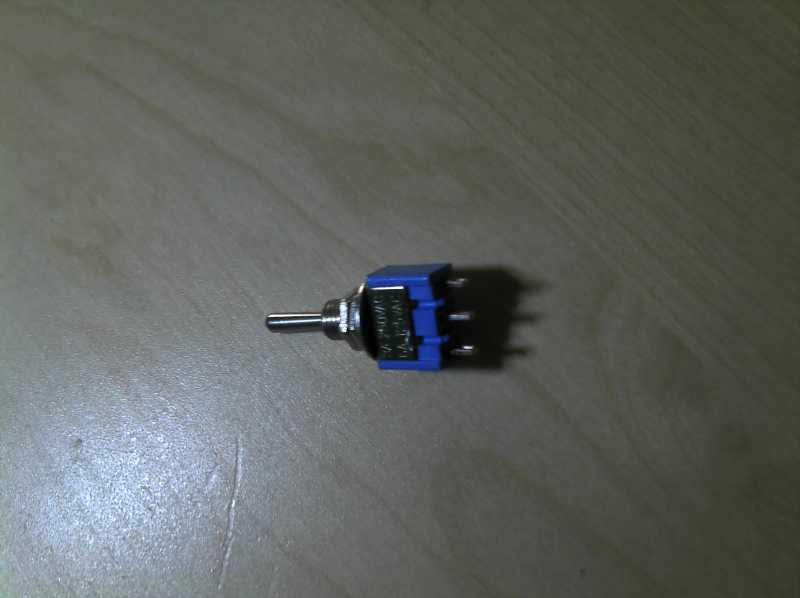

Replied by sbstnp on topic FMODE switch failed
I broke my FMODE on my Devo10 as well. Ordered a bunch from hobbyone because I couldn't find the flat handle type locally. But, in the meantime I bought some from a parts shop nearby and they worked ok.
This is what I used temporarily:

03 May 2013 11:01 #9502
Replied by rbe2012 on topic FMODE switch failed
It's only difficult to get switches with the longer arms...
From the electrical side a 3-position-switch is a switch which connects the middle pin to the left (pos0), none (pos1) or the right (pos2) pin. Such should be available at any electronic component dealer. Sizes are standard; watch for the hole diameter.
