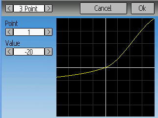

Question though.. Let's say I have a 3 point "curve" -20,0,+100. How would that smooth? I want a straight line from -20 to 0 and another straight line from 0 to +100. Would the smoothing only apply to 5 point curves and higher?

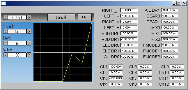

I had noticed a problem with a 13 point setting a few weeks ago. It was with V3.0.0 and a well formed throttle curve (a valid curve for a heli) but when this model was selected there was almost a 1 second delay on the throttle response, both on the heli and on the bar on the main page. I changed back to a 7 point curve and no more delay. I haven tried revisit or duplicating it yet, 7 points are all I need, but I thought mentioning it while you are looking at the curve smoothing and memory use.
On an earlier question - at least for Helicopters, 9 points curves are plenty and would be my vote if needed to reduce memory requirements.

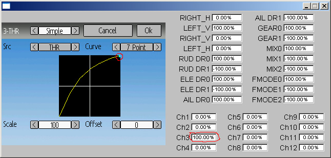

I've found one more artifact.
7 point curve, throttle (ch3), -100, -25, 25, 55, 75, 90, 100. If throttle (Ch3) = 100%, at channel monitor Ch3 = 0% (and at right panel of emulator). Any decrease and Ch3 value restored. If curve smooth = Off, all works as expected.
Smoothed curve
Curve without smoothing
Smoothed curve
